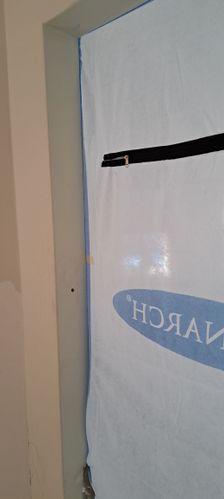

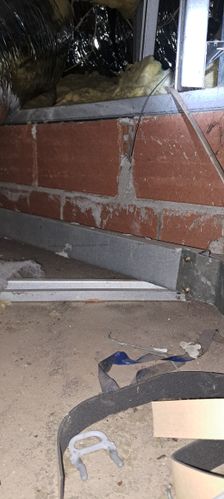

Hi all. Long time reader first time poster, bit stumped in my latest project, I want to fit two doors to an open living room. House is double brick, internal walls single. I planned to use Ramset plugs and long crews however have found out the brick work is laid internal cavities facing the door way so I just drill into nothing. Next option is chemset. pump the cavity full and apply construction adhesive to the flats. Apologies if it's not clear hopefully the photos will help. Second one is in the ceiling above the door way.

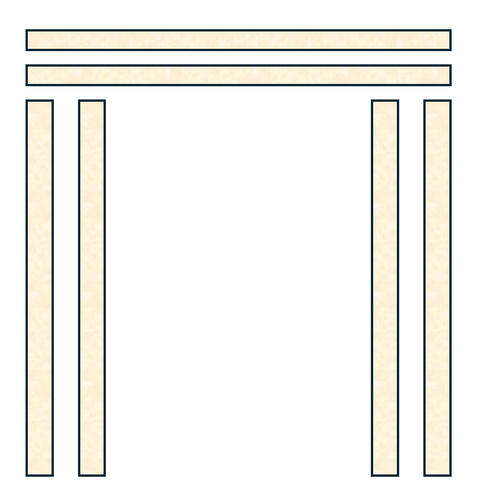

It might be necessary for you to use a timber filler such as 90 x 45 if you are using Chemset Ultrafix Plus. The anchors use a nut and bolt configuration, it will be necessary to counter sink the nut so that you can then place the door jamb over the timber filler and use ordinary screws to fix it in place.
I suggest using the following products to firmly anchor your door jamb filler in place if you have hollow bricks in your wall.

Hi @JustinMW
are you sure there is nothing solid (brick) on the external edges of the opening that the door frame could fasten securely to? I don't think it would be completely hollow otherwise the opening would have no structural strength at all other than the aluminium externals and plasterboard. You wouldn't need anything fancy like Chemist to fix the frame to, just masonry fasteners.

I am thinking along the same lines as @EricL in the addition of a timber filling piecem for the gap between the double brick and wall (If I am picturing it right?)
You could screw through the brick into the "spacer" piece of timber. Then when framing the door out you have something solid to attach the frame to.

Hi Nailbag, the house is all brick rendered and whitset plaster finish no plaster board at all. There ate no frames or mouldings anywhere its all just plastered brick. Western Australia located if that helps. Without removing all the whiteset and render back to bare brick I don't know exactly the make up, um just going off what what the wall looks like in the ceiling cavity un rendered and un plastered. It looks like standard 10 hole clay brick to me but I'm not a builder by any means.

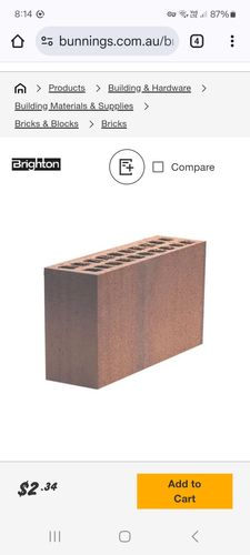

Hi Dave, it's a single brick wall where the bricks have been laid on their side so the 10 hole hollows are running horizontal to the wall and it looks like they have filled 30 or 40mm of the end of the brick with mortar then plaster finished over it. Very similar to the picture attached.im just not sure if chemset will hold in the cavity or pull straight out if forced.

Hi @JustinMW
If you use the Ramset Multifit Sieve - 4 Pack you should get a positive anchor even if there are hollow channels in the brick. I encourage you to watch the installation video to get a better idea on how the Chemset will anchor itself into hollow bricks.

Re: Thoughts on how to fix timber door jamb to brick passage
Thanks Eric I'll go down this route. The second opinion goes a long way when I'm stuck, thanks again.
