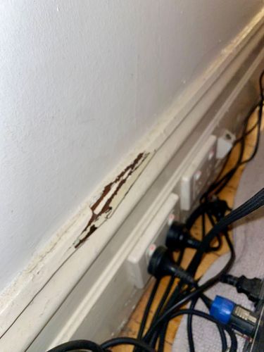

Hi everyone,
I accidentally dropped a picture frame and chipped my timber skirting board. What’s the best way to fix it? Any tips for a seamless repair? 😅
Thanks!

It looks like the damage is not so bad, I suggest removing the pieces that are complete loose and are no longer attached to skirting board itself. For the parts that are loose but still attached, I suggest using Selleys® 5g Power Grip™ Super Strong All Purpose Glue Adhesive to reattach them to the skirting board. For the gap that is left, I recommend using UNi-PRO 500g Multi Purpose Interior Filler - 500g. Your goal is to sculpt the filler in such a way that it will line up with the existing skirting boards design.
Once the filler cures, I suggest sanding the filler with a Rocket Sanding Sponge Kit - 10 Pack to get straight finish on the repair. Once you've finished sanding, I suggest visiting your local store and getting some colour sample cards from the paint department and see if you can find a similar colour to your skirting board. Once you find one ask the paint department to mix up a sample pot to touch up the damaged section.
