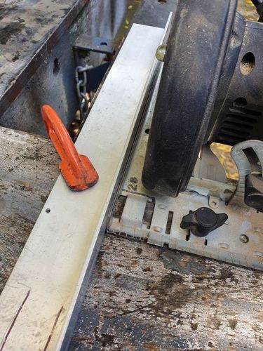

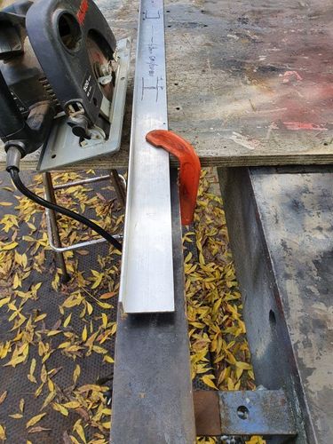

Plus - for cuts like this - I stole an idea from a woman on YouTube.
Building a rail adjacent to a work bench facilitates really good clamping ability incorporating the guide...
