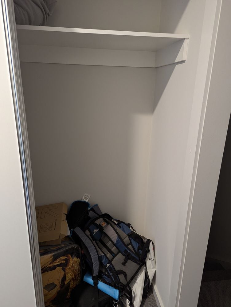

I've just moved into a new property and this is my linen closest which I'm disappointed with since its 1 shelf. I'm wanting to replicate this. Hoping someone can point me to the correct wood materials to use.

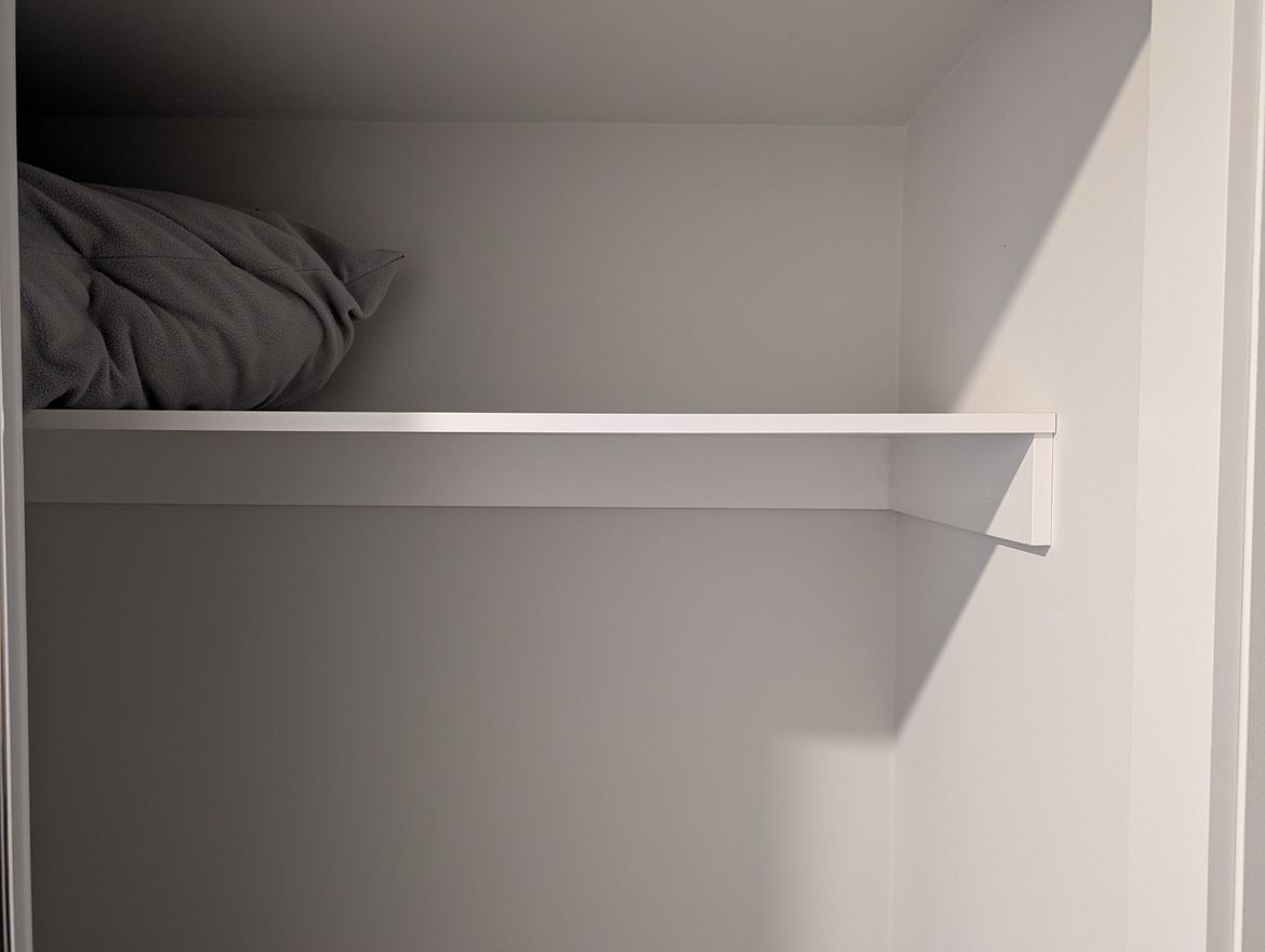

If you can tell me the dimensions where I have added arrows below, I'd be happy to point you in the right direction.
I suspect they have used something like this 92 x 18mm 5.4m Moulding White Pine for the cleats and 16mm White Particleboard for the shelf.
For steel framing, you can use metal screws like these Zenith 10G x 50mm Galvanised Countersunk Head Metal Screws to attach things to the studs.
When mounting heavy things, like a TV to steel frames, you should confirm a suitable method with the manufacturer of the mounting bracket and the producer of the steel framing. It is usually not as simple as using a wall anchor, and without a sufficient method, you risk twisting and damaging the steel framing.

The dimensions were around 16mm x 95mm.
Hi @Barnzey,
I thought it would be fairly close.
The method will be fairly easy to replicate, and you can even see the screw caps which indicate where they have put their screws.
You can use a level to trace down from their screws and then drive your own into the studs.
