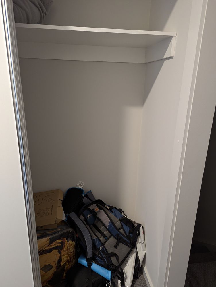

I've just moved into a new property and this is my linen closest which I'm disappointed with since its 1 shelf. I'm wanting to replicate this. Hoping someone can point me to the correct wood materials to use.

If you can tell me the dimensions where I have added arrows below, I'd be happy to point you in the right direction.
I suspect they have used something like this 92 x 18mm 5.4m Moulding White Pine for the cleats and 16mm White Particleboard for the shelf.
For steel framing, you can use metal screws like these Zenith 10G x 50mm Galvanised Countersunk Head Metal Screws to attach things to the studs.
When mounting heavy things, like a TV to steel frames, you should confirm a suitable method with the manufacturer of the mounting bracket and the producer of the steel framing. It is usually not as simple as using a wall anchor, and without a sufficient method, you risk twisting and damaging the steel framing.

The dimensions were around 16mm x 95mm.

The method will be fairly easy to replicate, and you can even see the screw caps which indicate where they have put their screws.
You can use a level to trace down from their screws and then drive your own into the studs.
