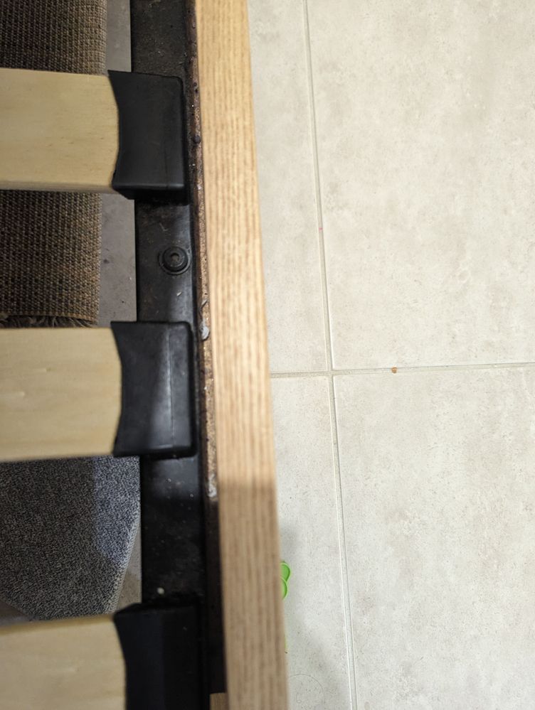

The method you rendered for attaching the rail to the bed frame looks very secure and easy to remove, however, I might have overlooked a detail in my original post. There's actually an additional piece of wood running along the bottom side of the vertical side panel on my bed frame [refer to attached photo]. Unfortunately, this would prevent bolting the guard rail directly as you suggested.
Do you, or anyone else on the forum, have any alternative suggestions for attaching the guard rail that would work around this additional piece of wood?
Thanks again for your help!

Hi @Neo19,
Is it possible to get some photos from other angles? Some measurements would certainly also help.
My assumption is that this black piece is a metal angle that doesn't run the full height of the bed rail. Is this correct?
An idea that should work assuming the black piece doesn't run the full height of the side rail of the bed.
It would act much the same as my original idea, there would just be some additional blocks attached to allow it to be flexed out to fit over the black piece then bolted in the same way.
If this is not going to work, please let me know. Some further details will certainly help in coming up with a solution that will work for you.
Let me know what you think, and if this will work for you or not.
