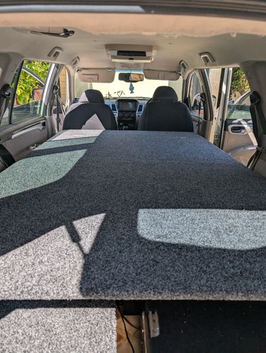

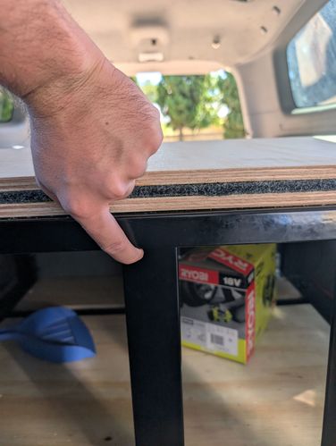

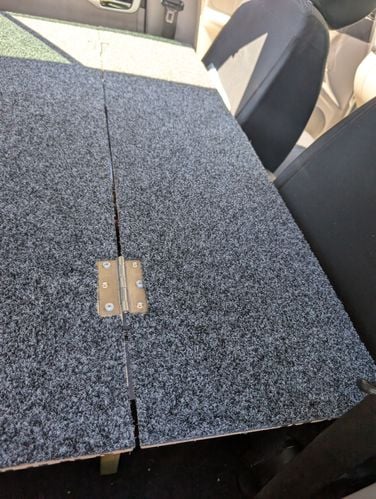

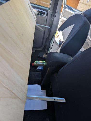

I almost finished my bed in my car (french backpacker, sorry for my english) but there is still the foldable extension that annoys me. I tried to fix some sliders to sustain this but it isn't solid. I have a hole where I can put a M6 bolt to fix something where my finger.m is Any idea without losing too much space?

It sounds like you're looking to support the corners of the folding section of your bed frame. A simple and effective solution is to cut two pieces of 42 x 42mm pine to the exact height from the platform to the floor. Attach a hinge to the top of each piece and secure the hinge to the underside of the folding platform, positioned at the corners.
When you fold the platform up, the supports will fold flat against it, and when you lower it, gravity will allow the supports to swing down into position, holding the platform steady. This design keeps it functional and compact without taking up extra space.
I've created a rendering to provide a better representation.
