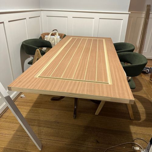

Step 1

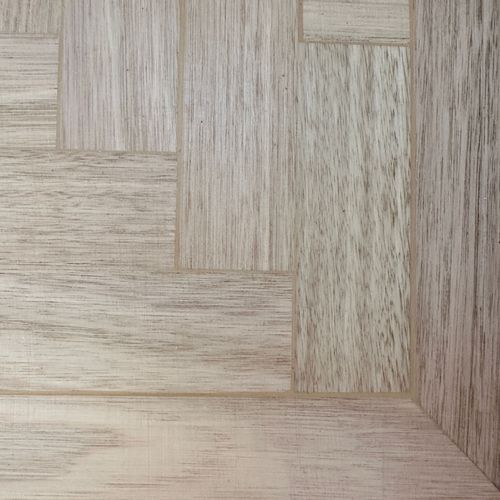

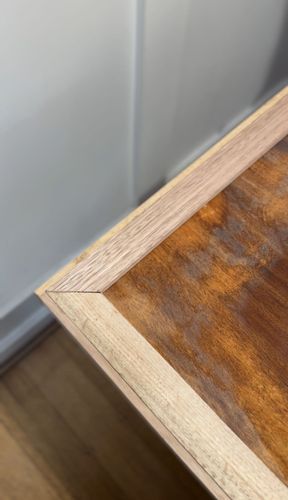

1/10Add external trim & frame
Adding a frame is important to cap off the edges of the wood. Adding it before assembling the table top ensures flush finish. As you can see we have used a template piece to ensure the correct height (8mm).
Use a nail gun or small nails to secure the trim to the surround of the table.
I wanted the picture frame look but you could just do the outer trim. If you like the picture frame, add the 45 deg mitred pieces the length & width of the table. Secure with wood glue.

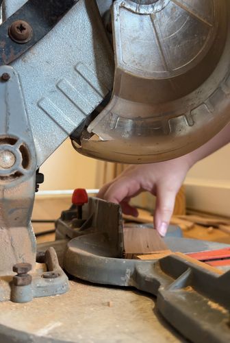

2/10Measure and cut pieces.. 
I decided on 120mm pieces because I liked the tight look and pattern.
TIP: with Herringbone the rule is multiples of the width (used 40mm pieces so measurements should be 80mm, 120mm, 160mm etc)
TIP: to work out how many pieces you need - work out the square cms of the table top (length x width, then divide amount by the square cm of each piece)

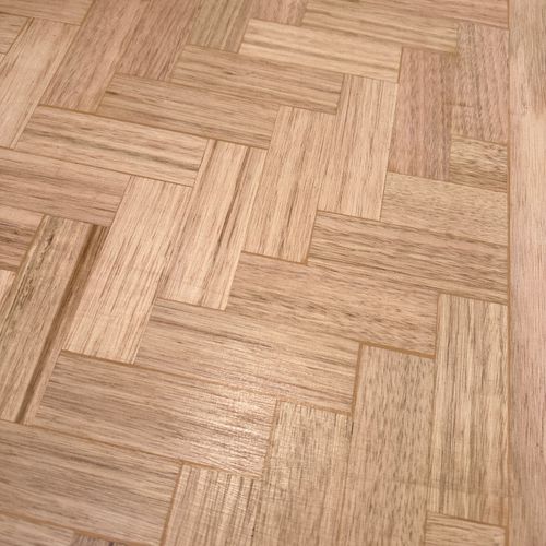

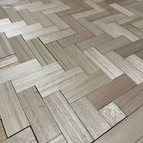

3/10Lay out all pieces in a pattern
There are templates online if you’re unsure. Filler prices of 80mm x 40mm and 40mm x 40mm were needed for this pattern.

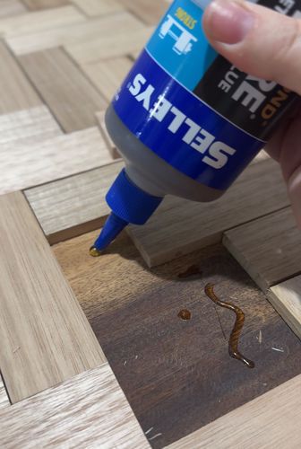

4/10Glue all the pieces down
TIP: add glue, press down piece, lift piece up and then press down again.
NOTE: the glue will foam & expand, that is normal which is why you only need a few drops.

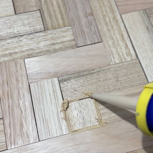

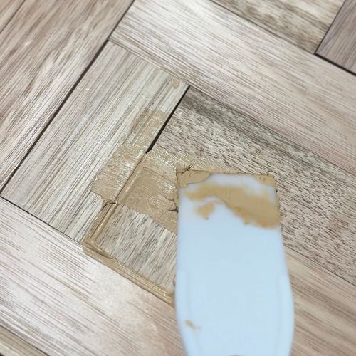

6/10Fill gaps with ‘No more gaps’
Scrape clean and wipe with wet cloth.

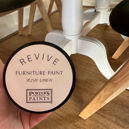

9/10Paint legs
TIP: light sand to remove shine, prep with any undercoat/primer then paint.

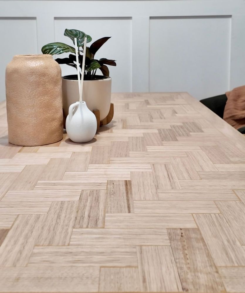

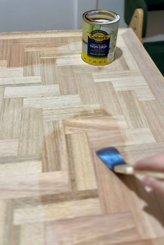

10/10Coat with Cabots
TIP: light sand (240 Grit) between coats.
And you’re done!
