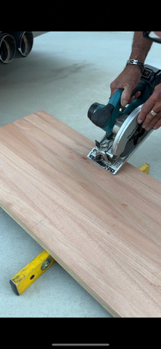

1/5Firstly I used the circular saw to cut the three pieces of timber needed. I measured the two leg pieces to be 500mm x 405(the width of the panel)
For the top I wanted a square so I made it 405 x 405mm as the panel was 405 wide.

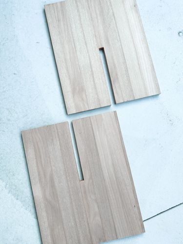

2/5Next I used a measuring tape to mark the cuts for the slot I needed to slide the two pieces together. This cut was 250mm (half the height of the legs) x 26mm (the thickness of the panels)
I used the jigsaw to cut this and a chisel to remove it and tidy up the cuts.

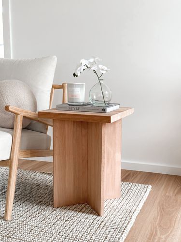

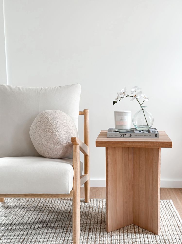

5/5And don't forget to style it! Here I styled it with a simple book, candle and K-Mart flower vase.
