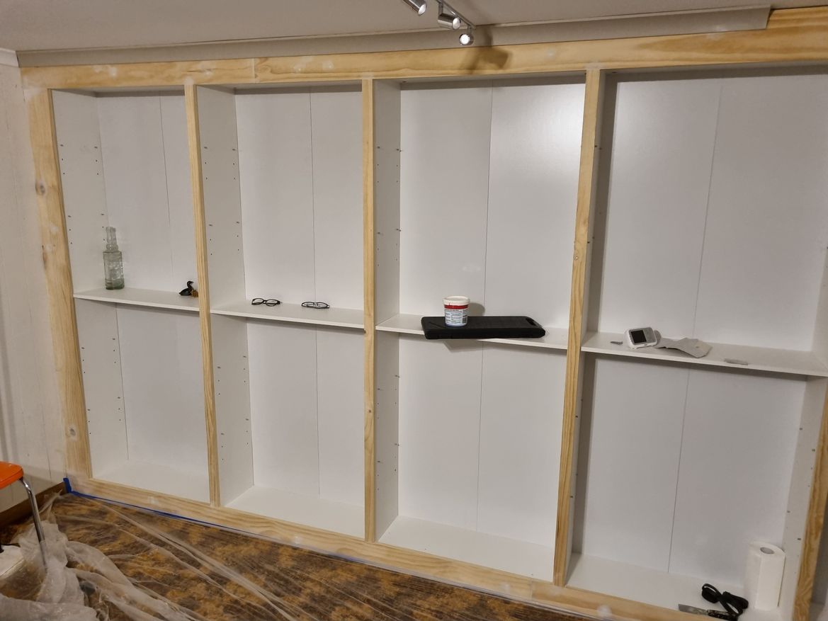

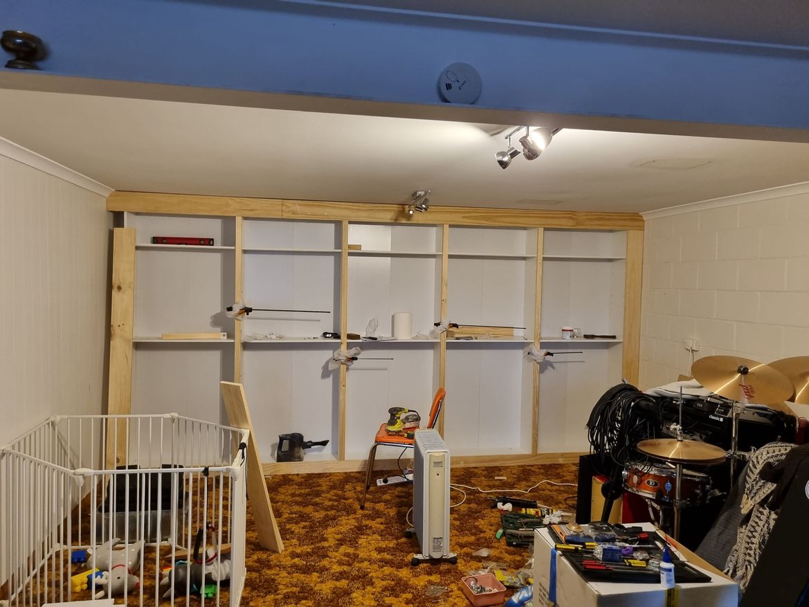

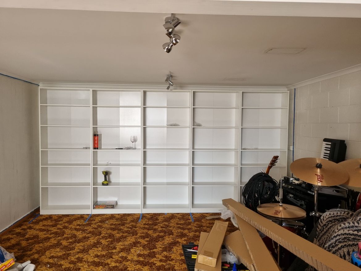

We used 5 Montgomery 80 x 28 x 202 cm white 6 Tier Bookcases, which we assembled and bolted together. Once they were bolted to the wall we got to work framing them in. We popped in some supports and then attached the timber to that. Our house is not square so we literally moved a wall to make it flush! We finished it off with a quick sand a some paint. I'm pretty stoked with how it has turned out! I am trying to decide whether we fill in the holes for the shelves and paint the inside of the bookcase or leave it so there's the option to move shelves around.

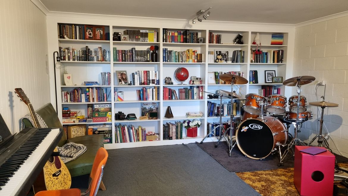

After: now we just need some more books, new carpet and some new lights.

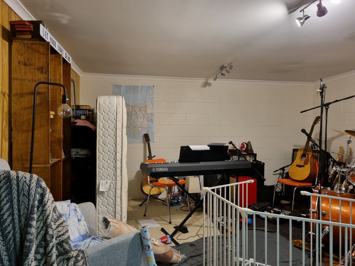

Before: the bookcases on the left had been removed from another house and were uneven, covered in nails and not overy functional
The room now that we've moved out stuff back in
