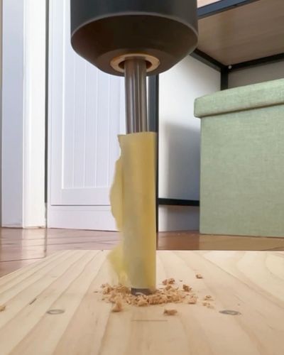

2. Once marked, drill the centre hole. Then smaller outer holes and screw the brackets down.
TIP
Mark the depth of the hole required on your drill piece with masking tape.

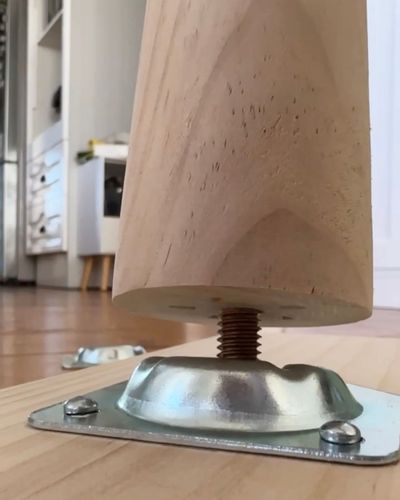

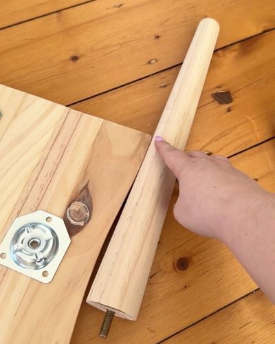

Step 3
3/4
3. Screw on the legs & check it stands
TIP
All four legs should tight and angled from the centre outwards

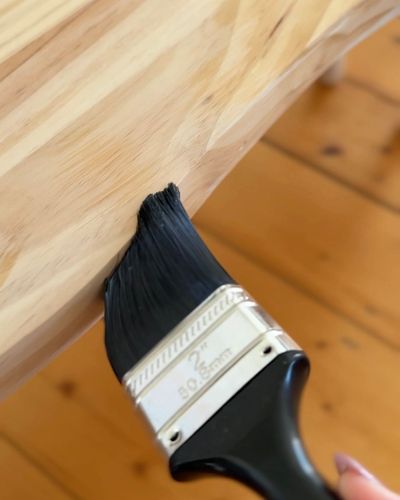

4. Add sealer/lacquer/oil
TIP
Always use a non-yellowing formula for sealers or a natural oil product to savour the tones of the wood. I have found @cabotsanz Clear CFP Floor - Water Based maintains the colour of the pine and protects surfaces really well.
