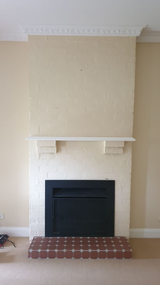

I'm looking to clad an open brick fireplace with stack stone. I was thinking of attaching cement sheets to the front and sides to give the stone a flat smooth surface to attach on to. Does this seem like a reasonable way to go about this?

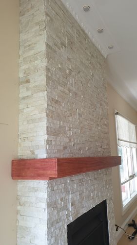

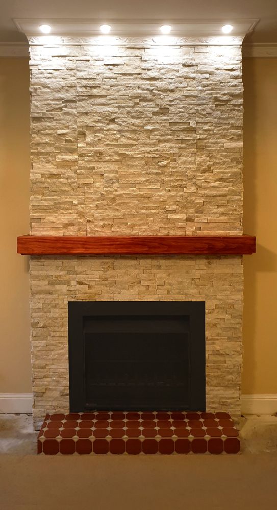

Quick update on the project - it came together quite well. I built a floating mantle and added some lights with a trim above to blend in with the existing crown moulding. Also lightly sanded the clay tile base and sealed with a gloss sealer. Apologies for the photo quality and shadows - the photo was taken late evening
Next step, painting and flooring

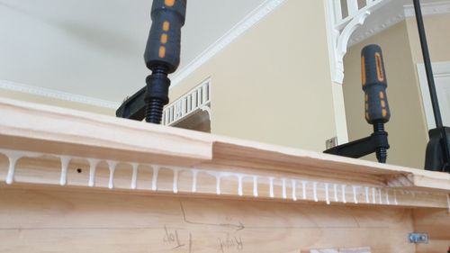

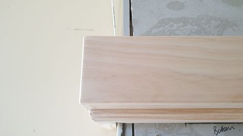

Here's a few build photos -

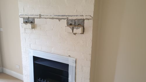

1. Started by removing the previous shelf and cutting the top layer of the brick corbels. The layer is used as a support for the floating mantel.
2. Cut and attached cladding using countersunk dynabolts (apologies didnt take a photo of this step).
3. Built the mantel using DAR pine. I routed a channel into the inside (bottom) of the mantel to accomodate the brick corbel before gluing, clamping and nailing from inside to avoid nail holes on the outside.
4. built the double returns on the mantle, routed an offset roman ogee trim layer on the underside and dry fit to check if it needed any adjustments.

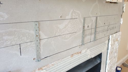

5. Added support brackets for the first layer or stone just above the fireplace opening.

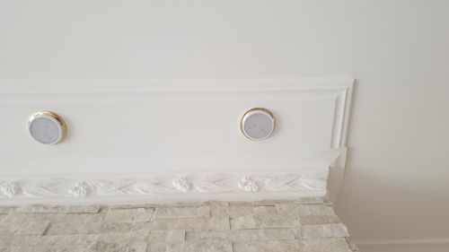

6. Continued with attaching the stone (approx 1m at a time) and built the light surround to match the thickness and length of the crown moulding.
Another angle of the finished fireplace:
