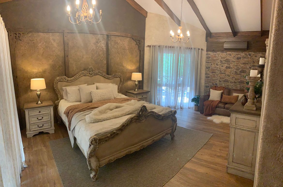

Part of my bedroom transformation was to create a unique feature wall. All made with plasterboard, joint compound, stencils, paint and timber.

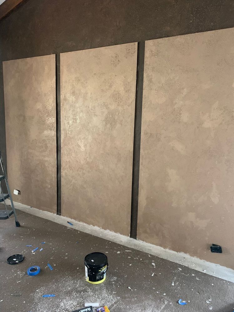

3/8Then it was time to overcome the rough uneven walls that wouldn't lend themselves to stencilling, but liquid-nailing 3 plasterboard panels to the wall - leaving space between each one for a timber surround.

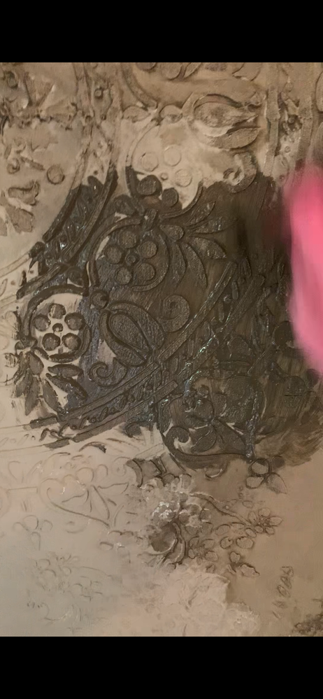

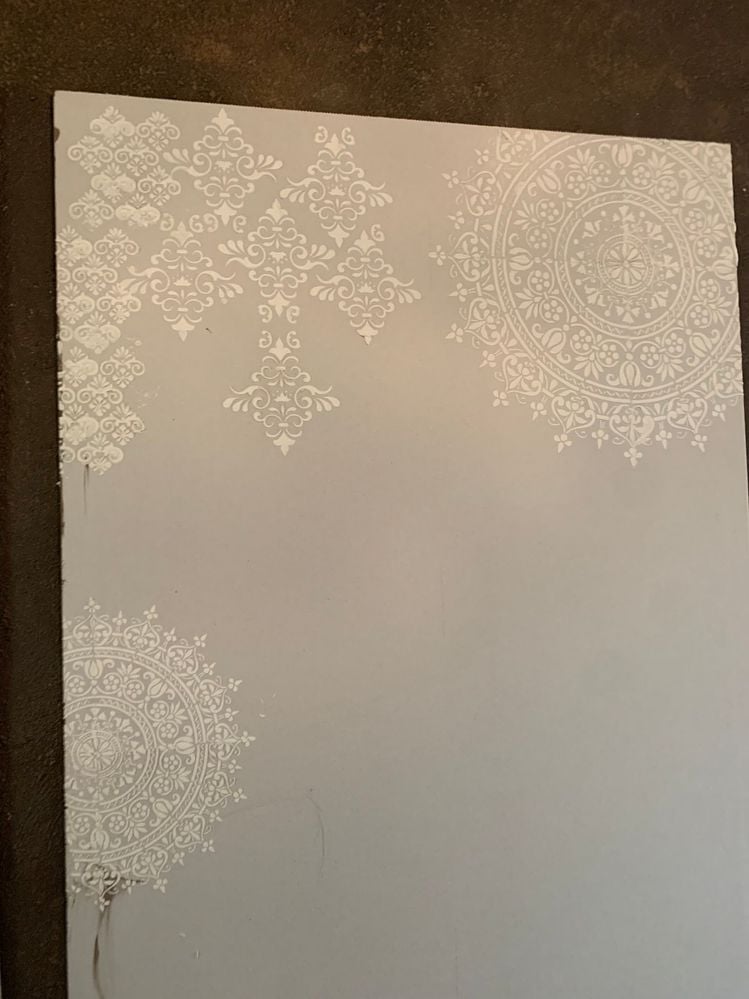

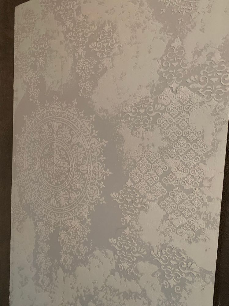

4/8Now the fun part! I had a selection of stencils that I used along with Jointing Compound to make a patterned/textured design that would also withstand a bit of sanding and painting.

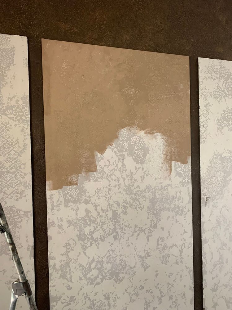

5/8Then a coat of a base colour over all the panels and stenciling.

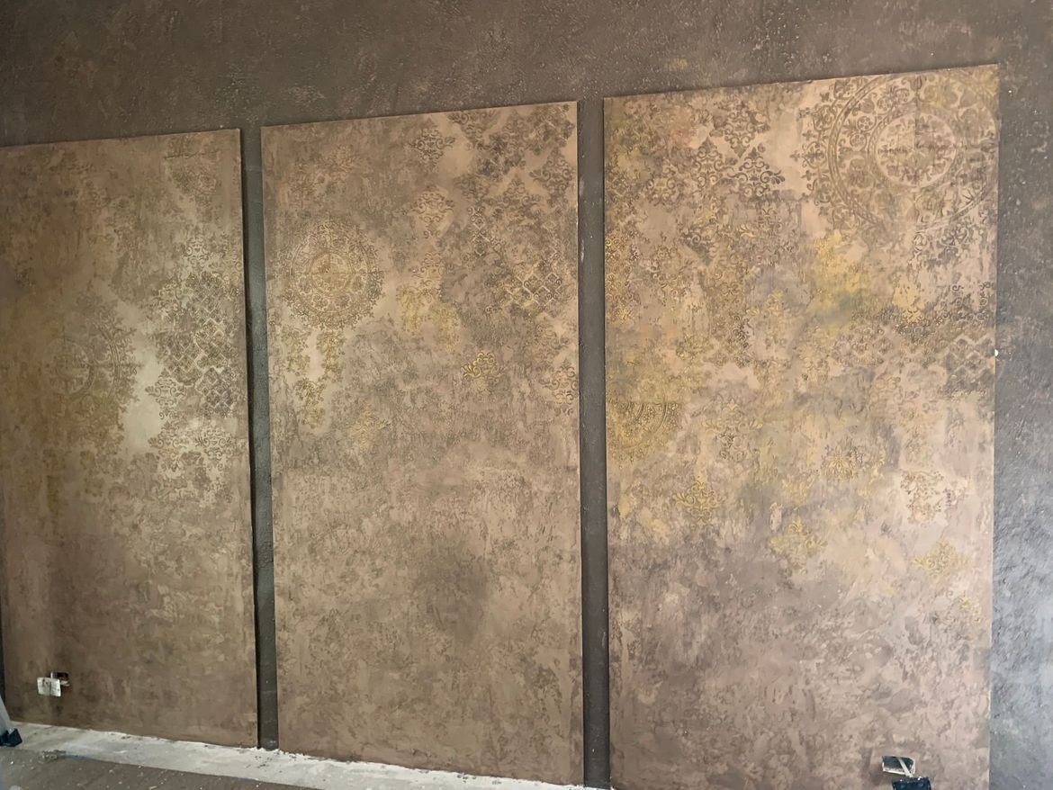

6/8Although I don't have lots of photos of the next bit, I used some dark watery paint to wash over the base colour, then wiped a lot of it off with cloths so it highlighted the pattern more. Then I added touches of subtle yellows and reds to create more different tones.

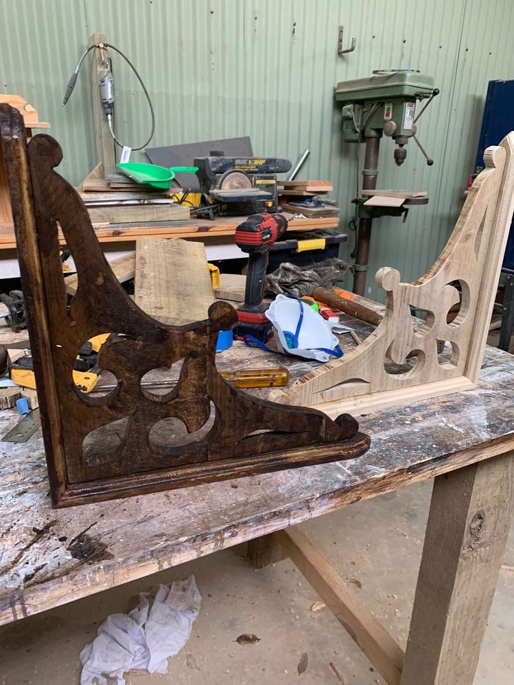

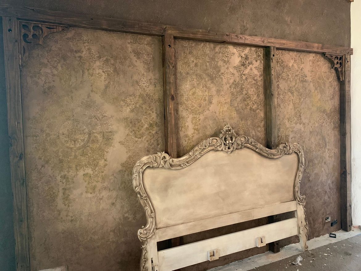

7/8I made some decorative wooden corners just stop it looking so square, and then added the timber framing. You can also see that I painted the bedroom furniture to match the new colour-scheme
Step 8

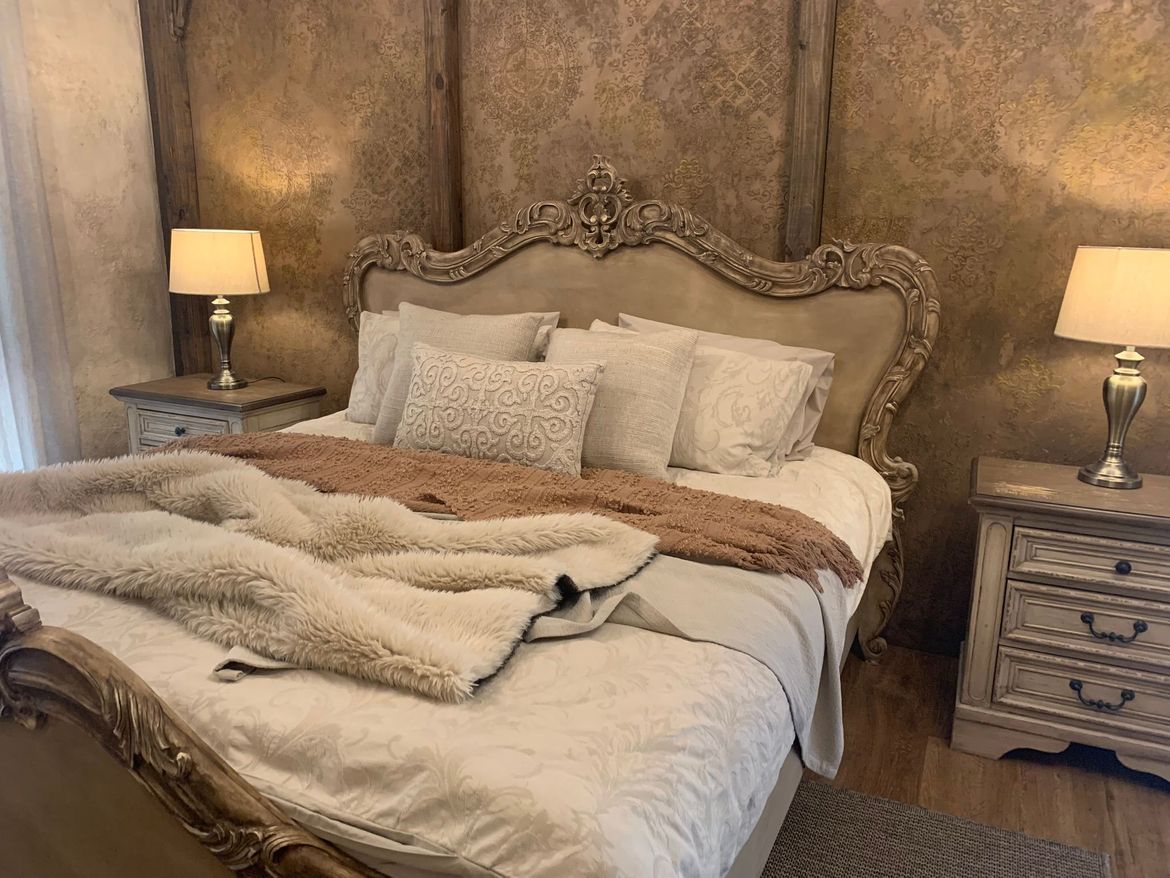

8/8Putting it all together with finishing touches.
