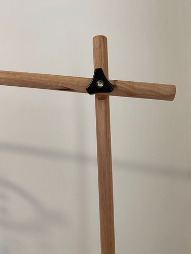

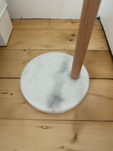

We were given this gorgeous mobile but were struggling to work out how to hang it above the change table. So we decided to make this stand out of Tasmanian Oak doweling and an old marble lamp base we had laying around. See below a list of materials purchased from Bunnings to assemble.

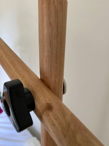

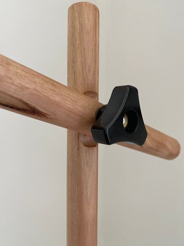

Dowel routed to adjust angle easily and secured by hand nut and bolt.

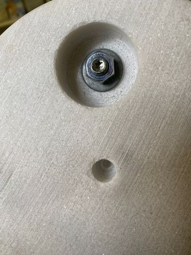

Stand secured to base with leg stud and nut.

Thanks also for the parts list - particularly this one - Hand Nut and Bolt.
