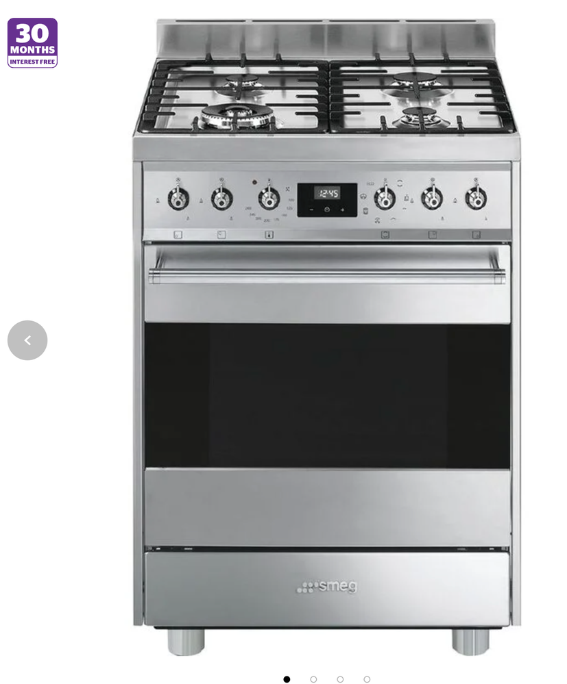

Hi guys,
My 1-year-old Smeg gas oven door is making a squeaking noise. Is CRC 75ml Silicone Grease the right product to lubricate the door hinge? If not, what's the right product to lubricate itScreenshot 2024-03-09 at 9.47.04 AM.pngScreenshot 2024-03-09 at 9.49.42 AM.png
Re: oven door making squeaking noise
Hi @mike1360,
Silicone would be a reasonable choice, but you might have more luck getting it into the hinge in spray form with WD-40 300g Specialist High Performance Silicone Lubricant. The can comes with a little straw nozzle, which is handy when directing the spray to internal parts like hinges. I suspect the grease would be difficult to apply unless you were to disassemble the hinge.
Given that the oven is only a year old, I'd encourage you to contact the manufacturer to determine the correct lubrication and whether they've experienced this issue before and have an advised procedure to rectify it.
