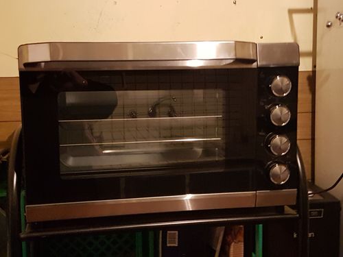

Thanks for getting back to me so quickly. The oven/grill is 38.5cm(H) x 55cm(W) x 43.2cm(D)
Re: benchtop protection
Hello @Lorpi
Can you please post a picture of it? Possibly a brand name? Thanks.
The brand is 'Anko' which is a Kmart homebrand.

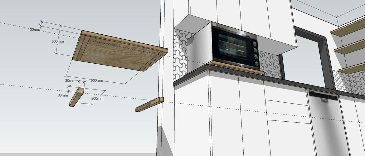

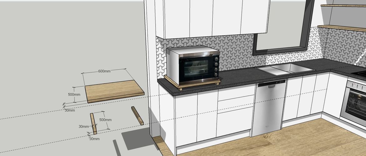

As a tenant myself I make sure that none of my appliances damage the bench top while I am renting my current home. I suggest a project panel 500mm x 600 x 30 or thicker if you wish. This will be your shield against the heat from the oven/grill, it also serves as your sacrificial piece, it can get wet damaged, burnt, scratched and violently handled. It's okay its meant to take the abuse, as long as it does not hurt the bench top below. Simply attach two timber strips at the bottom and these will serve as the feet for your oven grill pad. Good luck and stay safe.
