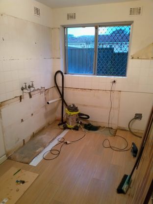

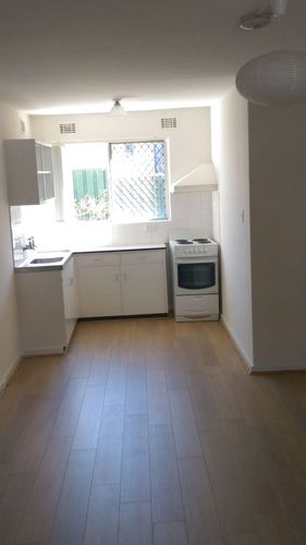

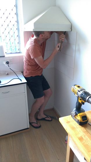

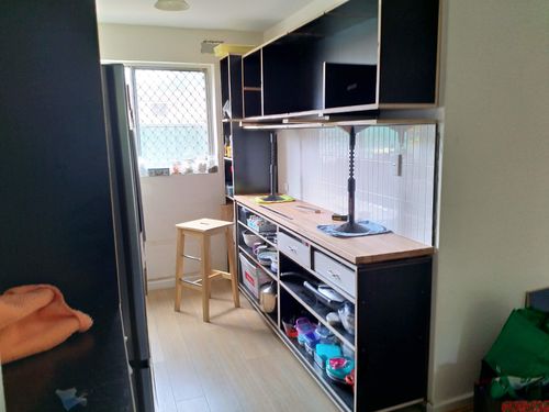

1/3Demolition. No description needed. We removed the worlds most basic kitchen. The range hood was a timber canopy and a hole in the wall. Enough said. It took one afternoon and wasn't difficult. 
Step 2

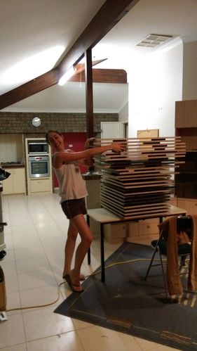

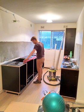

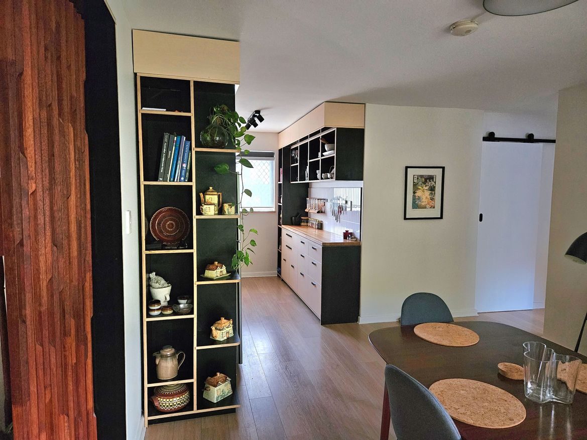

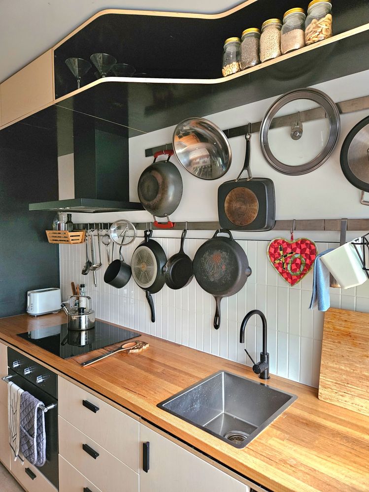

2/3Making the cabinetry. Oh god! It took quite a while. Many, many weekends in our friend's shed, as we were renovating a flat so had little space on site to work with. Form plywood was used as it is easy to work with, strong, termite resistant, readily available and cost effective. The black colour is a nice contrast to the white walls and provides a water resistant finish. We used an entire palette of the stuff for the whole apartment (50 x sheets).

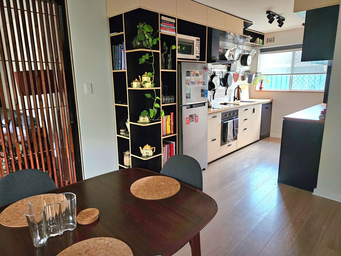

What a beautiful kitchen transformation! That is just a fantastic use of Formply, not only is it economical, but it saves you from having to paint one side of the panel. You've really outdone yourselves in the design phase of your kitchen. The curving shelves have so much appeal and the up to ceiling height construction has really maximized your storage area.
Can you please tell me how deep the cabinetry is on the other side of the cooktop? Looking at the photo it seems like you've reduced its depth or is it still 600mm deep standard?

Yes, thats right, the cabinetry on one side is narrower at 450 deep as we didn't wan't the kitchen to feel too cramped. This side works well as a work bench/ prep area, and all the services are located on the other side such as oven, sink, cooktop and fridge.
We thought about an 'L' shape kitchen, but I prefer the galley style, as it avoids awkward corner cupboards.
