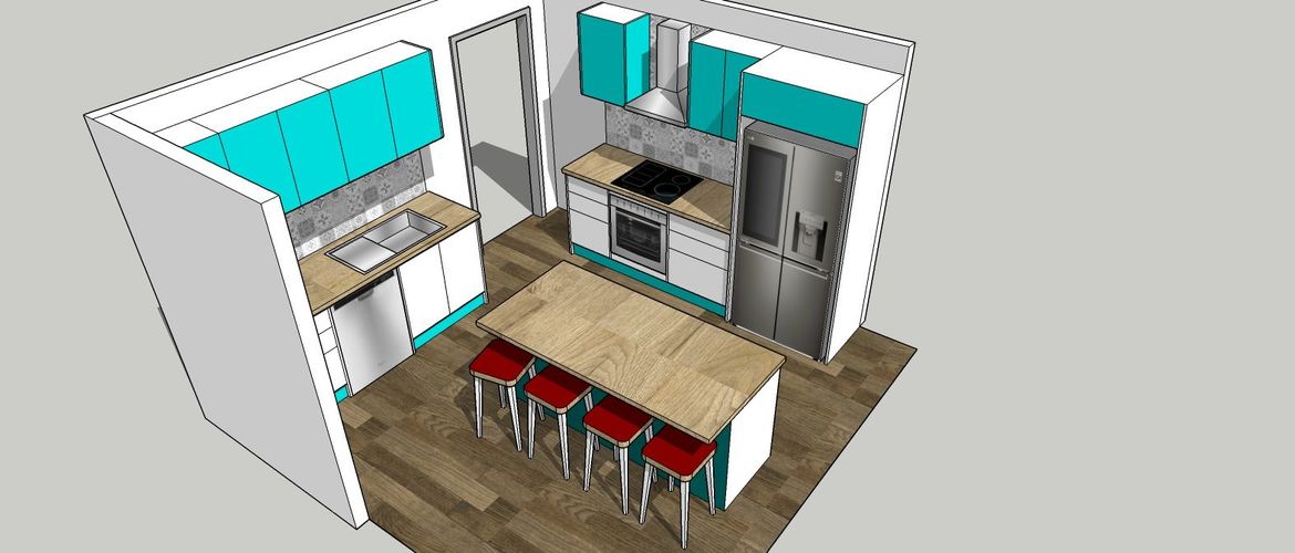

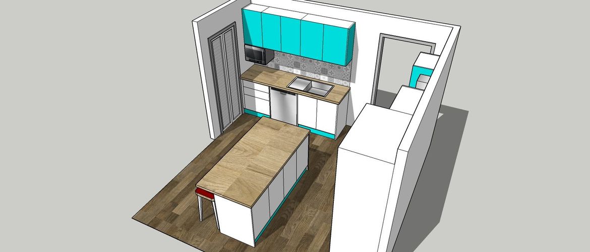

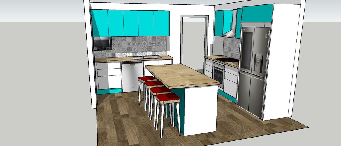

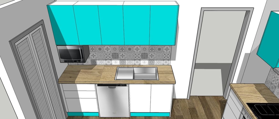

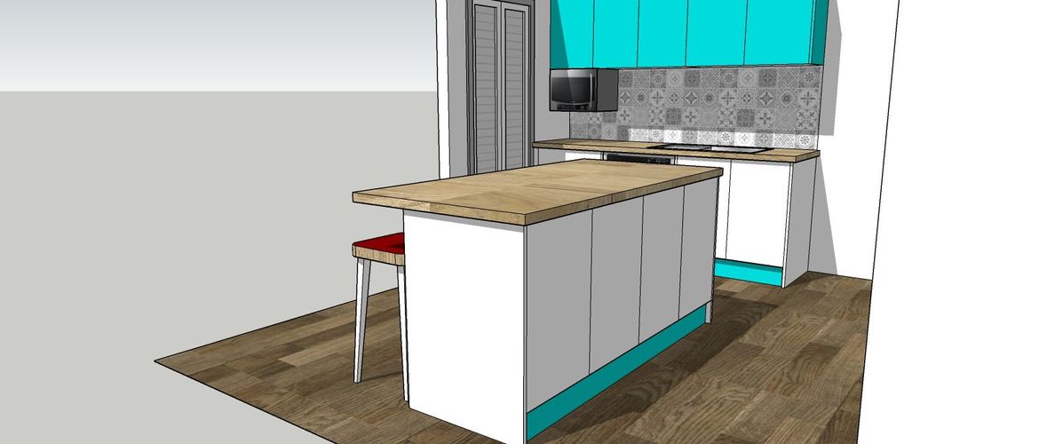

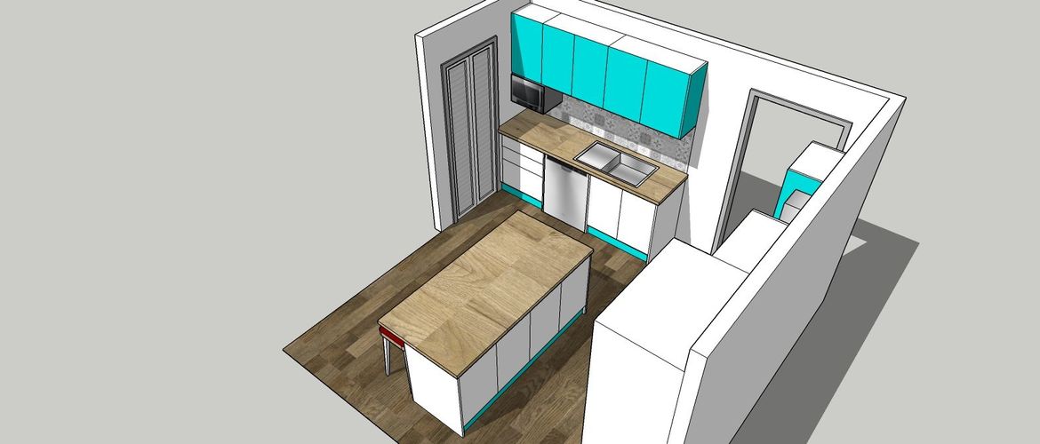

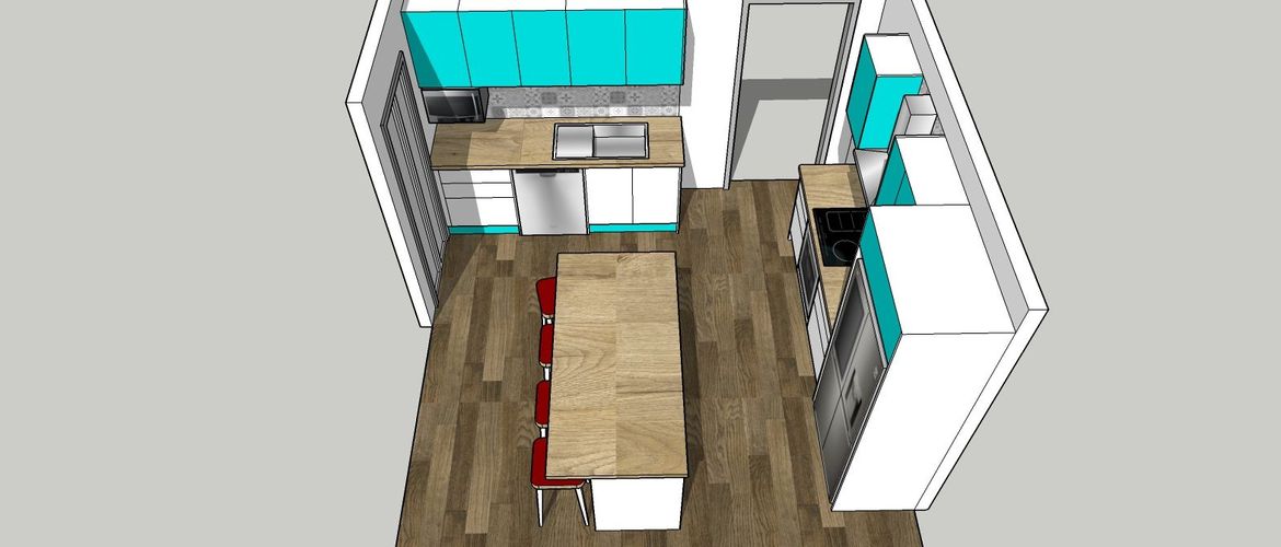

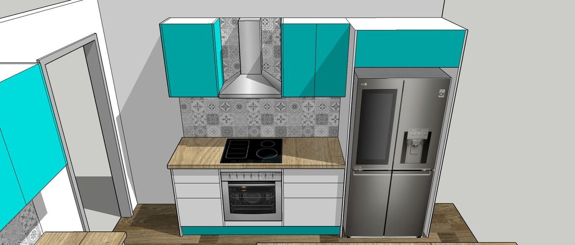

p.s. By the way I could not help myself I've drawn you a suggestion below with a little bit of 50's flavor added in to a new kitchen. Don't forget to put in a Sunbeam Mixmaster to complete the look.
Turquoise was all the rage back then and looks even more vouge with modern cabinets.
The answer is "Yes" there is enough space on both sides of the island for you to walk through.
That cabinet where you were going to put your fridge is now the pantry.
Just in case your wondering the island is 1.8 meters long
