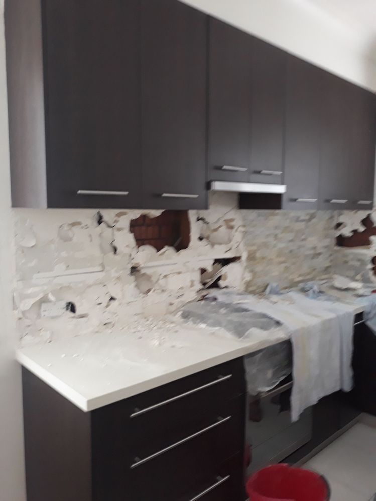

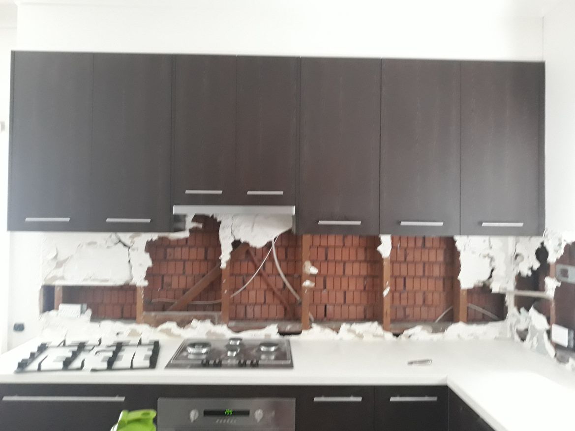

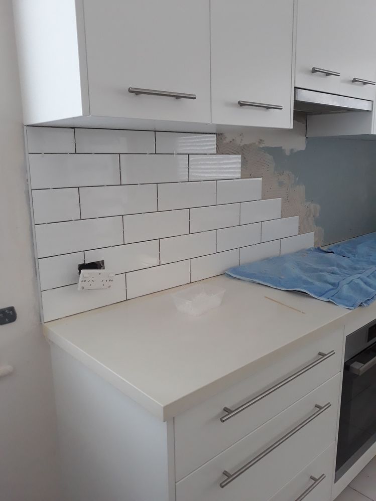

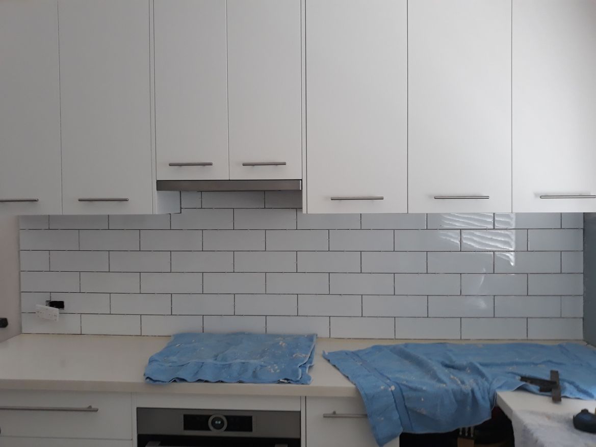

Just want to show some pictures of my splashback job I just finished sorry about the quality of some of the pictures as MitchellMc said allways get the right Tradesperson to isolate your services .As you can see my tiles did not come go so I had to replace the plasterboard in a kichen I would use Aquachek which is a waterproof plasterboard .it was not a hard job just have to measure thing out also I use a electrician bolster which I got from the toolshop at my local Bunnings.If you have any Questions just ask or go to your local Bunnings and ask a Team member.Just remember D.I.Y is Fun

Welcome to the Workshop community @Cado1. Thanks for jumping straight into the discussion.
What a fantastic first post! I am sure @Penny19 appreciates seeing first hand what a fantastic transformation replacing a splashback can make to a kitchen.

@Cado1 wow, what a difference. Looks fantastic. I’m assuming you painted the cupboards?
