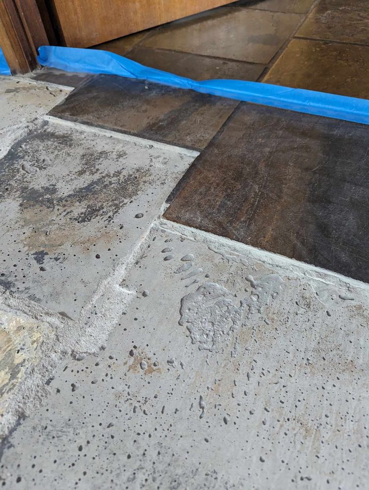

I currently have slate tiles in the kitchen and am trying to replace with floating hybrid boards.

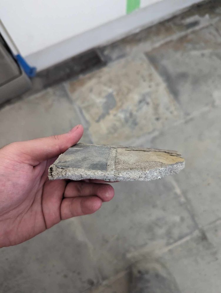

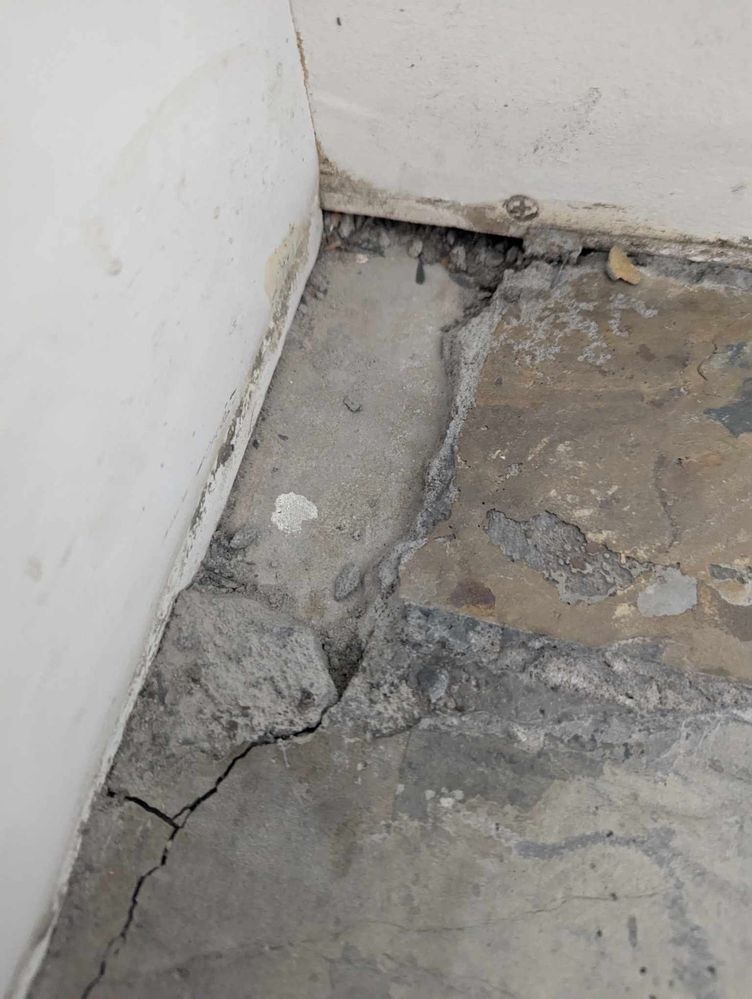

I was removing the last of the slate tiles in my kitchen and was about to start grinding, when a 1cm thick piece of cement broke off underneath the slate revealing a smooth concrete surface.
Now I'm wondering is this the actual slab? and if so should I remove the top layer of concrete as well to get to the smooth layer, as I'm not sure which layer is the actual slab.

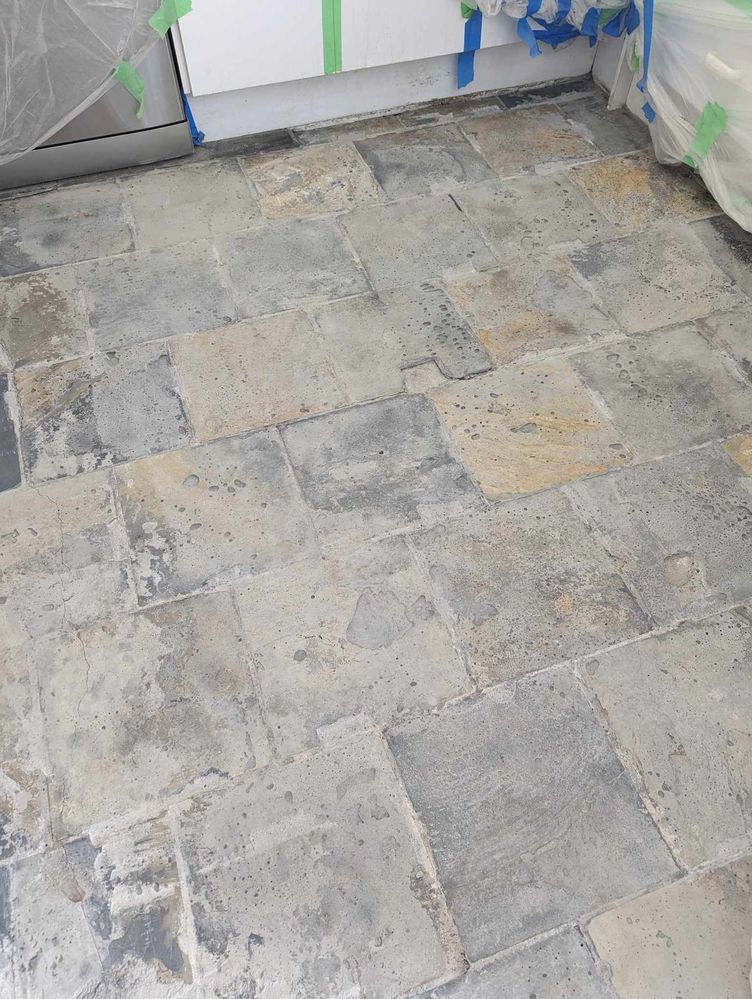

It's a bit hard to tell in your photos, but how much slate is left on the floor?

All the slate has been removed in that wide angle photo (2nd photo).
I'm suspecting that what is remaining is the mortar used to set in the slate tiles.
Should I remove this to get to the slab?

I ended up just removing the screed, since i found a few of the spots were actually coming loose after I disturbed it when I removed the tiles.
Then I just ground down any high spots in the slab with a grinder and diamond cup.
