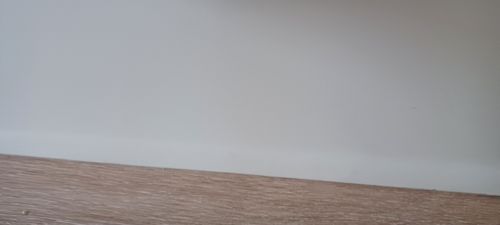

Thanks for your reply, not the kichen door but the side cabinet of the bench top, have attached a photo. If you look closely then you will notice a swelling at the bottom part. Will it be possible to sand it off and paint it?

Thank you for posting that photo of the damaged cabinet. Sanding it down could get tricky as the floor might get scratched because of how close it is. Is this panel inside or outside the dishwasher space? If the panels swelling is not immediately visible you could just paint over it. But you would need to silicone seal the bottom so that no more moisture enters that area.
The ideal solution of course is to remove the damaged panel and replace it with a new one. Once the new panel is in place it must be properly sealed with silicone to prevent the same type of damage from occurring.

I dont think you will be able to sand it down, once water gets into that type of timber it will swell 😕
I would remove it and replace it. If you look on the inside of your bench/cabinet you should see some screws going through to it. The panel should be a finishing panel and is just screwed to the end of a cabinet to make it look pretty. Kaboodle Gloss White Base End Panel is an example of what I mean.

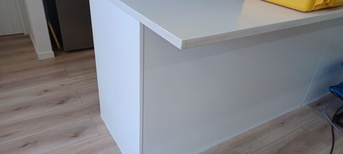

 Sorry, I supposed to send you this photo, the affected areas are not the dishwasher panel, the panels that supports the bench top those need some repair. What do you suggest?

If you are refering to that shiny panel on the left hand side of the photo it is a "cover" panel or end panel. It dosnt/shouldnt be carrying weight. The actual cupboard inside carrys the weight down to either a plinth or to adjustable feet. I do agree that it looks like it carrys the weight but nope It had me confused years ago when I was building my kitchen. \
Is there a chance you can show us a photo of the cabinet from the side the fridge is on? You should see the end panel, then a cupboard frame of some kind if you open the doors. If the dishwasher is there then there should be something that this end panel attaches to.

As @Dave-1 has mentioned, the swelling is not something that can be sanded through or really repaired. You'd be looking at removing and replacing the panels. If there hasn't been a leak within the cabinet, then the moisture exposure could be due to an un-sealed bottom edge of the panel and contact with water used when mopping the floor.
