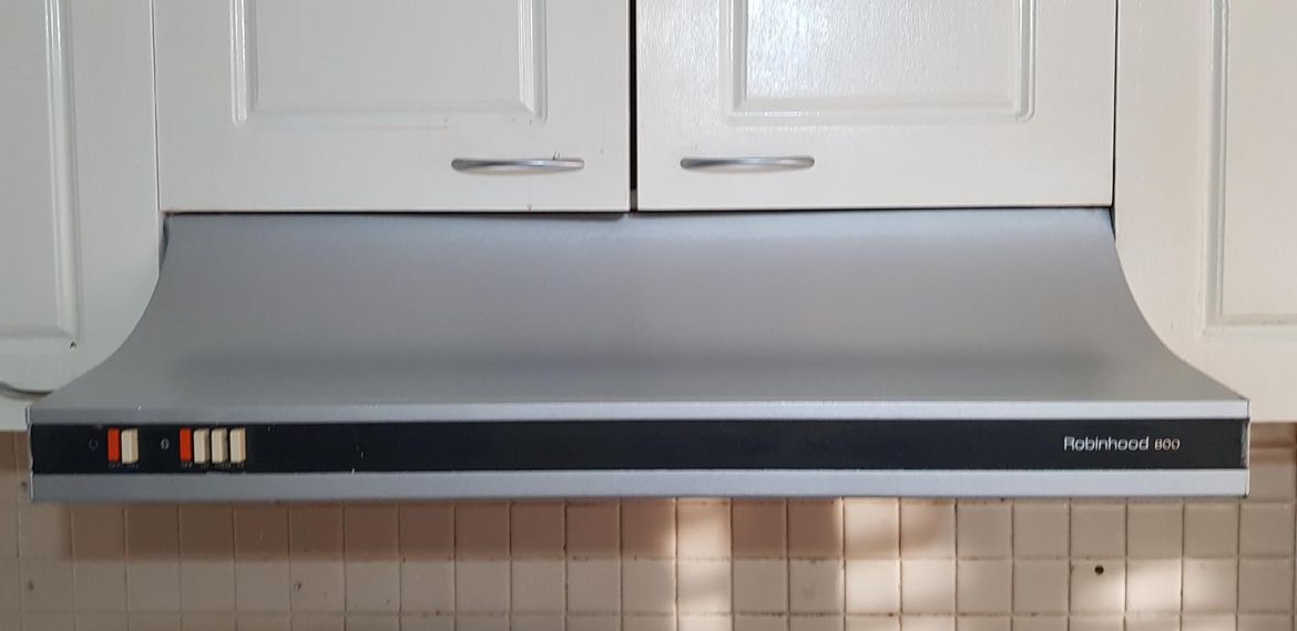

My old rangehood had seen better days, but it still worked ok. Rather than rip it out and replace it, I used appliance spray paint to give it a new lease on life.

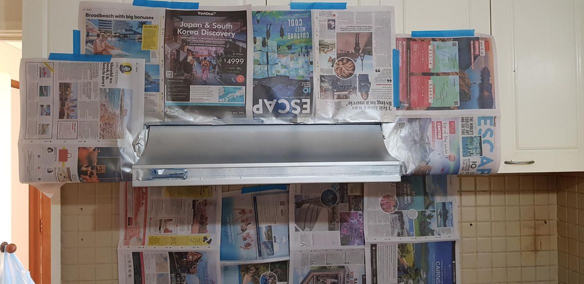

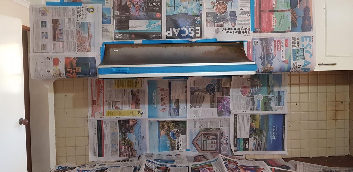

2/4Tape up around the edges and over any buttons or areas you don't want to be silver.
Tape newspaper to the surrounding cupboards to protect from overspray.

3/4Spray two coats of paint, allowing to dry between each coat.
If necessary a third coat can be applied to get a nice, thick, even coverage
Step 4
4/4Once dry, remove the tape and newspaper carefully.
I had a little bit of paint that snuck it's way onto the cupboard, but I was painting those later anyway.

Thank you so much for sharing your rangehood revamp. That paint job looks fantastic, it's given it a fresh new look and all the blemishes are gone. Thanks for posting that extra photo of your painting preparation. You've done an excellent job of covering your doors, splashback and benchtop. I'm sure this information will come in real handy for our members who are thinking about re-spraying their own rangehood.
