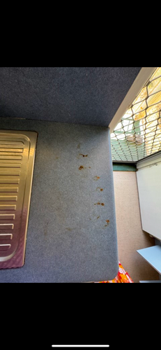

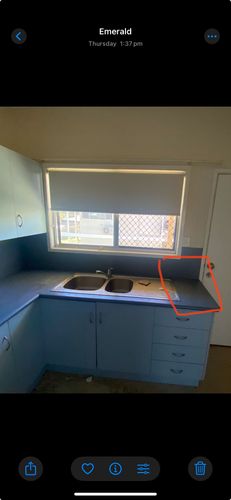

Hi guys could someone suggest me that what could possible done to repair the burnt patch of kitchen bench top.
i have been quoted more that $2500 To replace whole (u shaped top) bench top and said patch is not ideal for this old tiling which not e available

I propose using dishwashing liquid and water in combination with Mr Clean Sponge Scourer. Gently scrub the surface in order to reduce the burnt profile of the benchtop. Your objective is to make the harsh burns fade away but not to the point that it damages the finish of the benchtop. When you reach that point that where you know you can't scrub any further stop and start using the Mr Clean Eraser Pad Block. Make sure to cut only the size you need and always use it with water.
Once you've removed as much as you can take a photo of the benchtop and look for a paint colour that is close to the tone of the benchtop. Use a small paint brush and dab the surface of the damaged sections to blend it back into the benchtop. It is not a long-term repair procedure, but it will reduce the profile of the burned sections.
