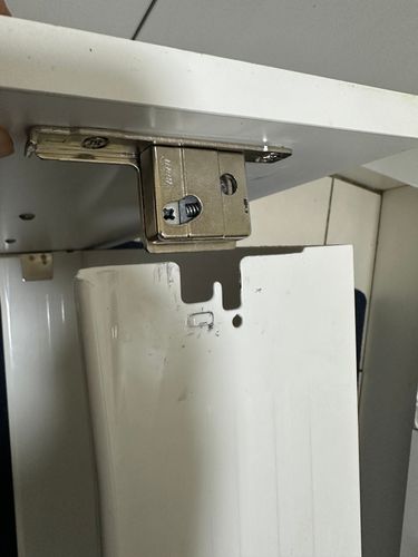

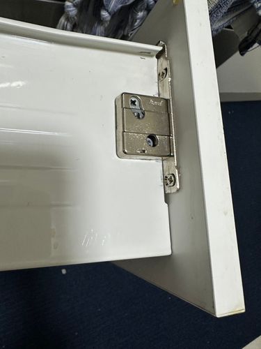

Can someone please tell me how to fix or unscrew and screw these on to the drawer? I have tried pushing these on to the drawer but it doesn’t stay put or click on the drawer. It stays loose.
Do i need to use glue or something? Any helpful videos please? Should i get a new one? Is it available at bunnings??

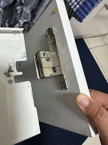

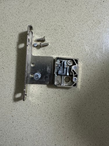

Thank you @EricL for your detailed response. Actually it is not the Blum drawer clips. It is some Harn Impaz brand (outdated version). I have a broken one (see the images) looks like it’s not the clip-on kind of drawer bracket.
Any idea if the Blum one would fit if I replace it with that one?

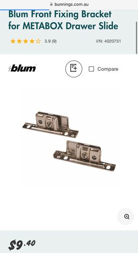

Hello @amydroid7
I suspect that a Blum Front Fixing Bracket for METABOX Drawer Slide might work with your drawer set. I suggest bringing the old drawer clips along with your drawer and testing it at the shop to make sure that it fits.
I propose speaking to the hardware specialist at the store as they will be able to identify and find out if the Blum set will work on your drawer sides. Please make sure to bring your drawer front as well to determine if the front bracket spacing is also compatible.

Just an update that it might be helpful for anyone else:
I got the Blum brackets (image attached). And the drawers are sorted for now (even though the outside covering/bracket doesn’t really fit our drawers) but they are still a better and tighter fir than the original ones as one of the screw can be tightened to keep the face of the drawer attached to the drawer’s body.
I didn’t had to drill anything. The length was a good match.
