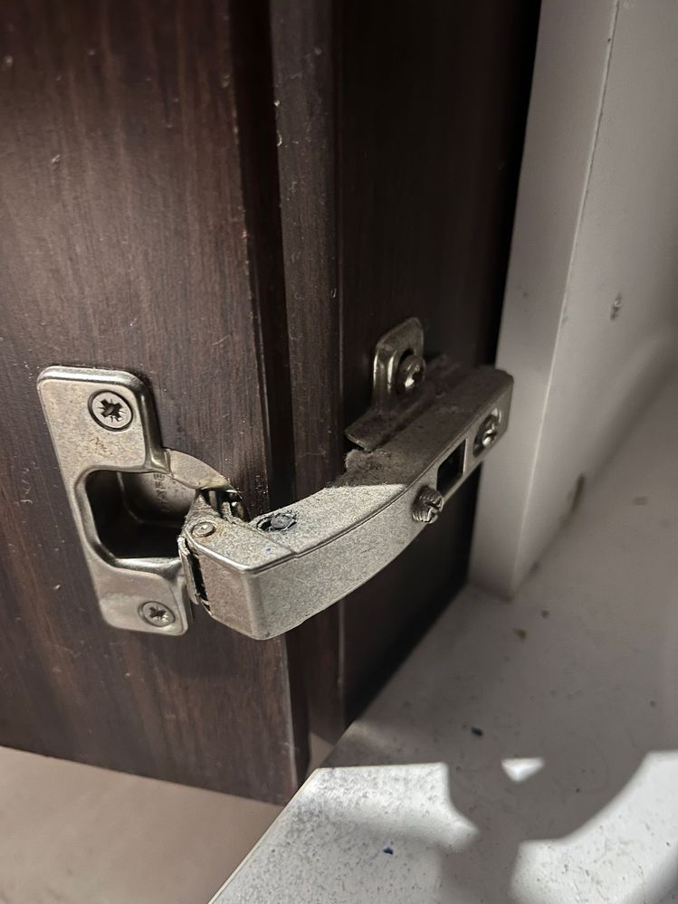

The Hinge on one of the kitchen doors is broken. I need to find a replacement one, but in most cases the hinges begin at 90 degree when the door is closed and goes to 180 degree when the door is open.
In this case the hinge is at 180 degree when door is closed and moves to 270 degree when door is open. I have attached a picture below. Is it possible to get a hinge like this at Bunnings and what are they called. Thank You

It appears to be a blind corner hinge. I suggest removing the functioning hinge and bringing it with you to the store and comparing it with the Kaboodle Blind Corner Cabinet Hinge - 1 Pair or the Hafele Nickel Plated 94° Salice Blind Corner Clip On Hinge. Please note that when replacing a hinge both hinges must be replaced so that the door will function properly.
