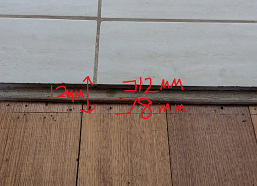

I've recently removed carpet from the two entrances to the kitchen (which is tiled).
The result is I now have hardwood floors connecting with the tile in a stabby-toe situation that also makes it hard for our 15 month old to roll his walkers etc over it.
On one entrance:
There's 8mm in height worth of cement(?) under the tile, which acts as a 'step' to the hardwood.
There's an additional 12mm of tile height.
The distance of exposed cement(?) is about 12mm
The other is
5mm cement, 15mm tile over a 25mm distance.
