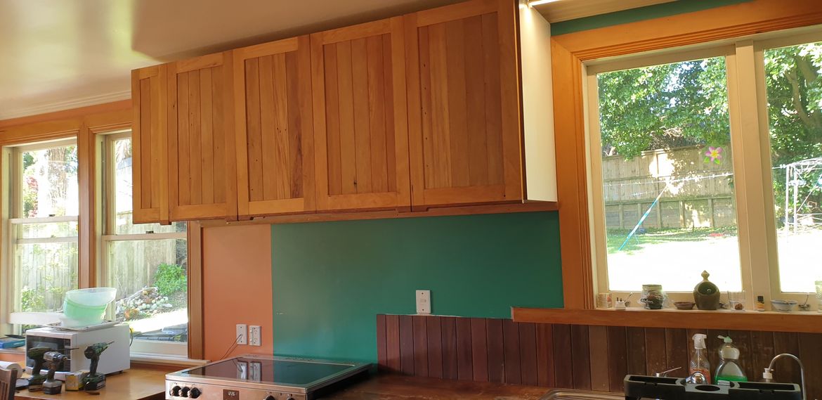

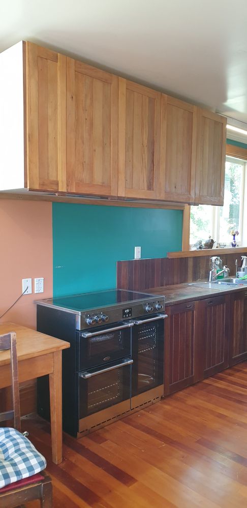

New stove, and she who must be obeyed wanted the range hood disguised. Had to be in keeping with the rest of the kitchen plus extend between windows. Ended up being a 5 door, two shelf cabinet, 2100 x 680 x 500. Recycled Rimu, TG&V doors to match existing furniture. Melamine shelving and divides.
Materials
Tools
16mm Melamine sheet x 3 https://www.bunnings.co.nz/ibs-mini-panel-2400-x-600-x-16mm-white-melamine_p0294499
Door hinges x 5 https://www.bunnings.co.nz/kaboodle-kitset-hinges-2pk_p2662006
Soft stop plugs
25 metres Recycled Rimu.
Mahogany edge tape
Glue https://www.bunnings.co.nz/international-175gm-epiglue-epoxy-glue_p0439843
Table saw
Electric sander
Battery drill
Battery screw driver
Electric router
