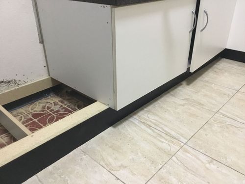

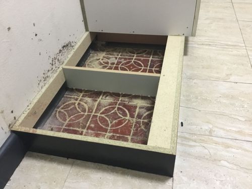

hi, I don’t if possible, thought I would make a post and see.
I am renovating my kitchen on a budget. I have found out the previous owner put the current kitchen tiles over the orig tiles and the newer tiles go up the edge of the current cabinet walls.
With the blueprint for the new ikea kitchen, I need to fill in a small space with a ceramic tile undergarment or concrete sheet so there is no gap to the the proposed cabinets on the left wall,
I would look to hire a floor tiler or a handyman to do this since I have never done something like this.
Do u know if it can be done?
Handyman can look to just glue a concrete board etc in that space from the concrete subfloor to top of existing tiles? as long as it’s perfectly level to the existing tiles is all that matters as I will then later cover the entire floor in lvt planks, so  it doesn’t matter that the colours will clash as it will be hidden under the planks,
Space to fill in is rectangular, 270mm wide by 1770mm long.
A few old red tiles would have to removed also so the section is all concrete base,
Expect the old tiles with the new tiles are about 35mm off the concrete floor.
If going ahead, I would remove the current cabinet so the area is all accessible.
tx in advance for any advise, I’m trying to sort the floor with the costly and lengthy time option if ripping it all up..

Hi there, I have found out even if I lay 2mm LVT on the top tiles it likely will be too high as a levelling compound likely has to be put down on the top tiles first.
So im trying to find out if there is a way for me to remove completely the top level of tiles myself  and leave the bottom tiles only for the floor installer.
ie use a multi function tool like the ozito one at https://www.bunnings.com.au/ozito-300w-multi-function-tool_p6290554 to carefully remove the top level of tiles. Iwould only buy that if I knew I could remove the top tiles and leave the bottom ones.
it would probably be 40mm or so from the concrete subfloor, but it doesn’t matter the measurement as I would tell the kitchen installer the height of the LVT planks that would be put in and they adjust the height of the cabinets so it would be flush.
then the kitchen would be all good to install.
sry it’s a bit hard to show as  need to fully remove a cabinet to get access but see more pics attached
tx for your help
