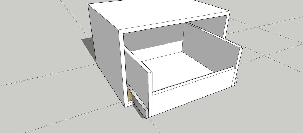

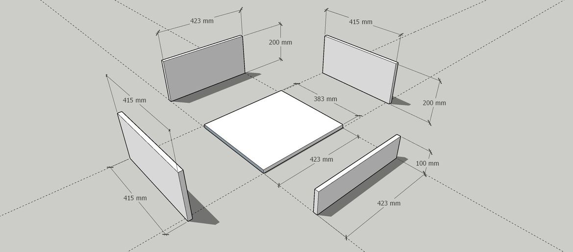

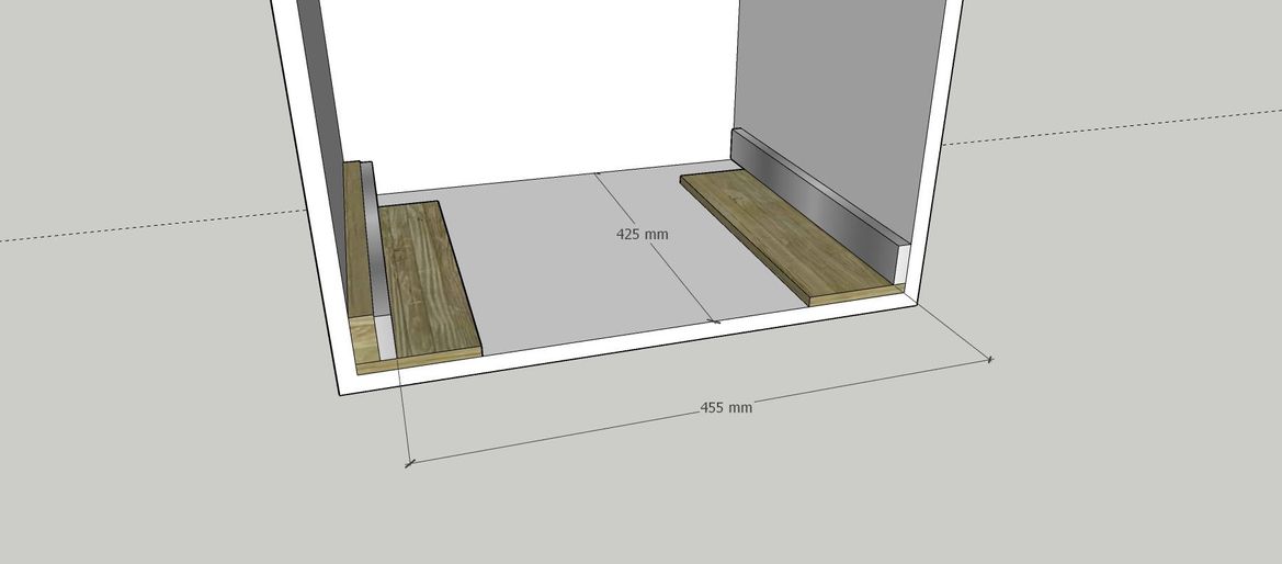

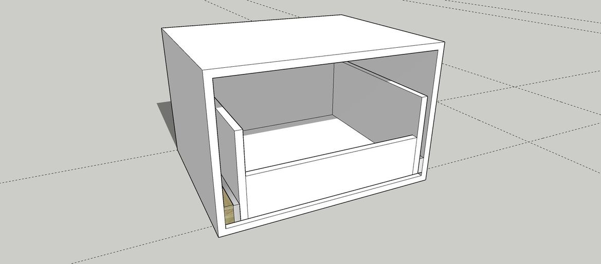

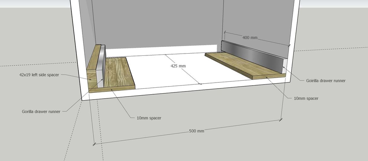

Re: How to cut shelves without disassembling?
Hello @Kathy88
Below are the images you can use to guide your carpenter on how to build the drawer for your pantry. Generally speaking, it is made of five panels, two drawer runners and a spacer on the left so that it avoids hitting the door on the left. The size of the spacer is dependent on the thickness of the door. The thicker the door the thicker the spacer will need to be. For the drawer on the right the spacer will need to be on the right-hand side.
I've used standard MDF at 16mm thickness for your drawer material. I strongly suggest reading this guide - How to add drawers to a kitchen cabinet. This will give your carpenter a good idea of how to put the drawer together and how to install it.
The measurements I've placed are based on the measurements you've provided. Please double check them and adjust them to your needs before you start cutting the timber.
Kathry88 drawer 1.jpgKathry88 drawer 2.jpgKathry88 drawer 3.jpgKathry88 drawer 4.jpgKathry88 drawer 5.jpgKathry88 drawer 6.jpgKathry88 drawer 7.jpg
