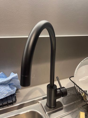

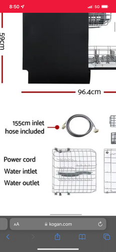

Hi, I’m looking at buying a devanti Benchtop dishwasher and need to know if there is an attachment that I can buy to connect the dishwasher to my tap? I have attached photos for reference

I often recommend using the Kinetic Adaptor Aerator Kit when attaching the inlet hose of a benchtop dishwasher. However, the gooseneck-type sink mixers have a very peculiar outlet size and the thread type on their aerators is very fine. Thus making the Kinetic Adaptor possibly incompatible. I suggest having a quick look at this discussion - Benchtop dishwasher quick release connection by @jenenev

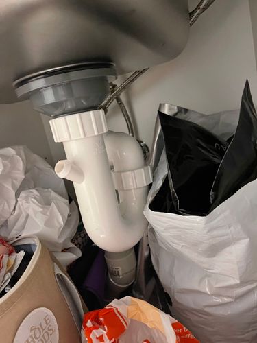

My only other suggestion would be to engage the services of a plumber and get them to install a suitable tap under your sink for you to connect your dishwasher too. In the meantime, if you can tell me which is the closest tap you have near your kitchen, I can try and help you connect from that point.

is there a way I can connect the dishwasher to the pipes under my sink somehow?

Can we start by seeing the aerator threads on your tap? Unscrew the aerator off the end of the tap spout and take a picture for us. The Kinetic Adaptor Aerator Kit comes with a fine thread adaptor and suits most tap types. Perhaps @EricL is aware of an incompatibility I haven't heard of in this tap style. That's the first place to start, though. If the adaptor doesn't work, we can devise another option.
