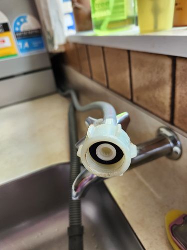

I just purchased a Vogue countertop dishwasher and trying to find how to attach water inlet hose to my kitchen tap please?
This is hose and tap pic..
I am in New Zealand..

I dont think there are any DIY soloutions you simply need a water outlet for your dish washer.
Take this to bunnings and ask their guy there for advice Or @EricL is good on plumbing he might be able to help
The only hope is to take the water tap/spout off and install a tee water junction there as a possibility it will need a tap too

There are a few options for you to connect your dishwasher to the cold water outlet. First, is to unscrew the cold tap and attach a Brasshards 15mm Brass Threaded Tee in combination with a Brasshards 15mm Brass Threaded Hexagon Nipple. This will allow you to screw the cold tap back onto the "Tee". You'll then need to attach a Brasshards 20mm Chrome Loose Nut Mini Washing Machine Tap in combination with a Brasshards 15mm Brass Threaded Hexagon Nipple into the open side of the tee.
The next option is to get your garden hose and attach a Pope 12mm Universal Tap Adaptor along with a Philmac 3/4" BSP Thread Pipe Nipple. You'll need to pass your gardenhose through your window to connect the inlet of the dishwasher. The other way to attach your dishwasher is to get a registered plumber to drill through your benchtop and attach it from underneath onto the outlet of the cold water. Please make sure to use a Kinetic 12mm x 10m White Standard Thread Seal on all the threaded fittings.
Please note that if you are in a rental property it's important to ask permission before carrying out any changes to the plumbing. Also please be aware that a registered plumber might be required to carry out these modifications. Please make sure to wear safety equipment such as gloves and safety goggles when doing plumbing work.
