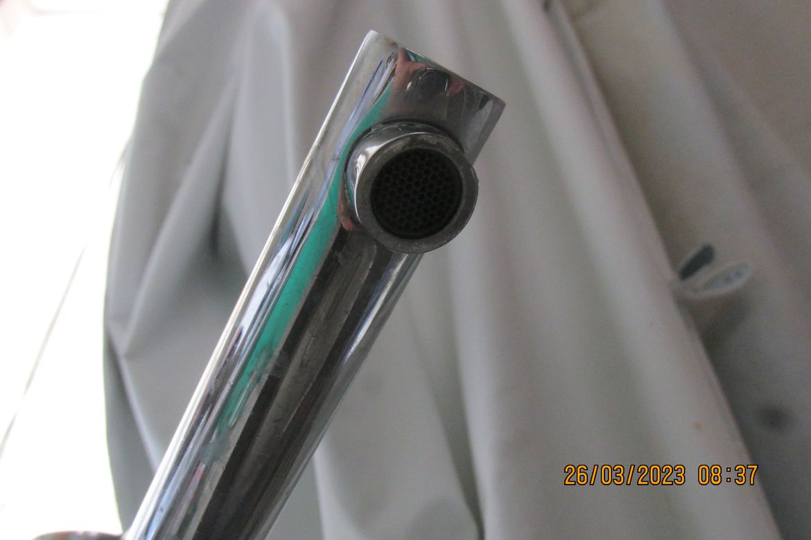

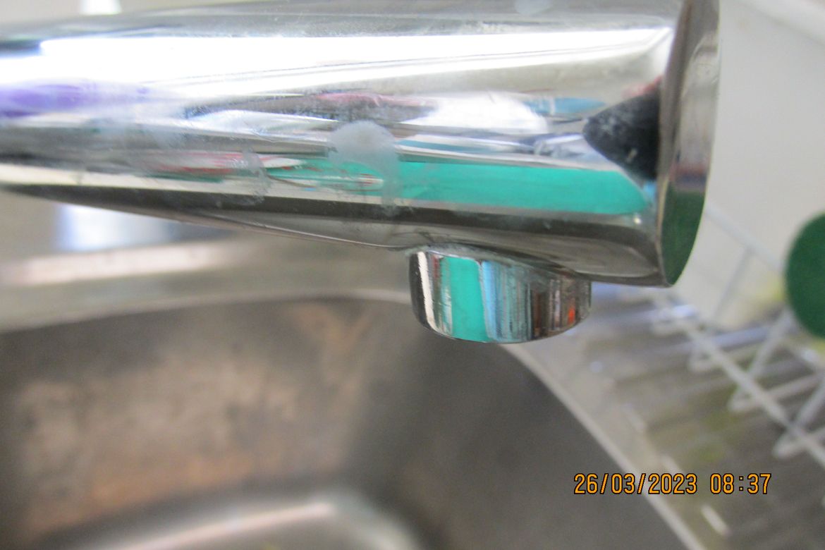

is there a single tap that has the screw in end so I can attach a bench top dishwasher ?? ( I live in a rental ) I tried to find an adaptor for this nozzle but there is none. so it looks like I have to change the whole thing ( hope this makes sense )

My apologies for the late reply. I went to the store to double check if the Kinetic Adaptor Aerator Kit would fit into your tap end. Unfortunately, the secondary part was too big, and it would not seal properly.
The options open to you are to either change the tapware that you have or have the plumber attach a washing machine tap under the sink. It would be more practical to link the dishwasher under the sink as this will let you use the kitchen tap even while the dishwasher is running.
