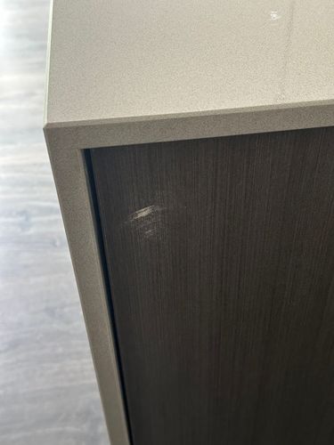

I have a kitchen laminate cabinet that has a scratch mark on it that doesn’t look very nice. I don’t want to buy a new cabinet door as one day I’d like to change all of them. Any genius ideas?

You could try using Waxstix Touch-Up Crayons for a quick and easy fix. These crayons are designed to cover scratches and marks on laminate and wooden surfaces. Simply choose a colour that closely matches the finish of your cabinet, rub the crayon into the scratch, and wipe off any excess with a soft cloth. This will help blend the scratch with the rest of the surface, making it less noticeable. It's a cost-effective solution, especially if you're planning to replace the cabinets in the future.
I'd look at picking up both a walnut and ebony-coloured Waxstix. Start by covering the area with the walnut colour and then come back and add the vertical grain lines with the ebony.

Thank you very much! Very helpful!
