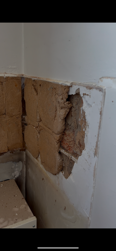

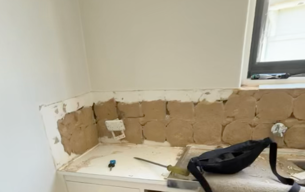

Hi we're currently doing a kitchen reno and wanted to replace our kitchen tiles to make room for the new cabinets (will be different heights) as well as use different tiles for backsplash.
We've removed the tiles and realized the wall is completely brick, but there is mortar and sand I think infront of all of the brick to make it level and bring the wall out for the tiles to sit on.
I haven't removed all of the mortar as I wasn't sure if that is what I'm supposed to do. There are quite a few large gaps in the brick wall from what I could see and was afraid that I would cause damage / uncover massive holes.
I saw someone online say just to remove all of it and place a cement sheet on top in order to create a flat surface. What is the best course of action here? The mortar is also up on the window sill too under the window frame. Tried removing some but it cause the frame to lift up so we stopped.

It appears that a few short cuts were taken in the levelling of the brick wall. If it appears that the mortar used is still in good condition and are not falling off the wall, I suggest doing an integrity test on the mortar face. Put both hands on the other mortar and see if you can pull them off the wall. If they are rock steady and have withstood the test, you can now begin to get things ready for rendering. I propose using Dunlop 20kg Multipurpose Acrylic Render to fill in the gaps and holes in the wall.
However, if the mortar is soft and is easy to take off, you'll have no choice but to re-render your wall.

Depending on what you want for your splashback and how far out you are willing to have it you have two choices. pretty much what @EricL has suggested. I prefer the removal of the mortar and start with a clean slate. It might feel like more effort but teh outcome you know will be new and one that has nothing hidden. Its always teh case with any tytpe of renos, lift the lid and find 3 things under it
To remove the mortar, I would use a cold chisel and hammer and "gently" work my way accross the surface. Then I would wire brush the surface once all the raised bits are removed. Kango 25mm Cold Chisel There are also cold chisels with a rubber cap at the top to protect your hands. They are def something to consider.

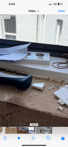

under the window frame when I pried the tiles off it also seemed to bring up the window frame as the tiles sit under the frame. What should we do there?

You could go the route of villaboard as it will give a smooth surface tho I think removing the excess and then rendering over it to be flush with the existing wall may be a smoother transition.
Maybe wait until you remove the excess and see how smooth the surface is after the work. Then judge what is needed. Remember that new cabinetry will cover some of the wall, new splashback or tiles may cover other parts. You may need to only render smooth instead of using villaboard on top.

Do you holes that go into the bricks themselves? I didnt see any in your photos?
The Acrylic render will be a paste like substance I suspect, it shouldnt be runny at all.
Once you have removed the existing "over supply" of mud that has been left then you will see how deep the holes may be. We can then suggest ways to fill te holes if needed

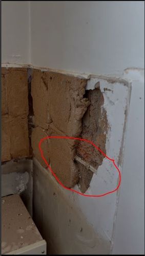

Here are some photos where the gap seems quite large, we haven’t removed it all yet just because we weren’t sure if we would be able to fill the gaps
Re: Removing kitchen tiles from brick
Afternoon @JR2
Are you going to change your cabinetry around or benchtop?
The hole in the corner looks deepo but cant quiet tell how deep.

The power point will have to be moved, you will need an electrician for this. Just noticed in your second photo at the top of this thread what may be an electical cable embedded in mortar? If that is correct then I would stop work and talk to an electrican before chiseling or redoing anything as it is not safe.
Once you verify if its a cable or something else then its back to stepping through the questions as to what you want.
