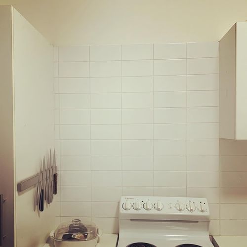

An empty space, some inspiration, a sketch and a trip to Bunnings #proud

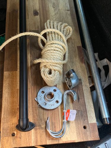

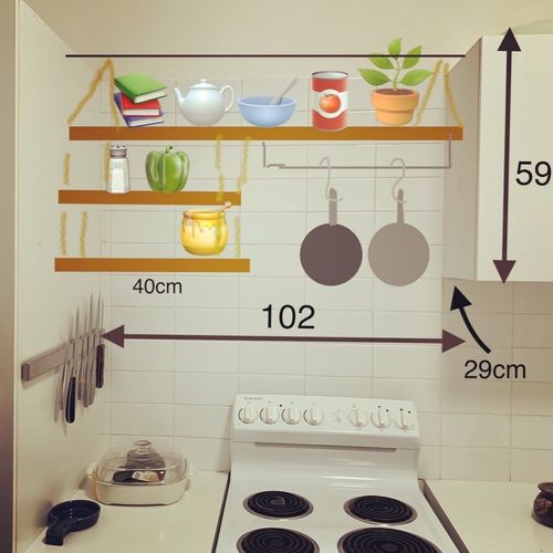

Thank you @StevieB! I knew I needed a shelf with minimal drilling into the walls and Pinterest was great for ideas.
I used SpecRite food grade timber panels and Grunt rope with a load rating of 400kg. The holes into the timber were drilled at a slightly larger diameter than the rope - use sticky tape on the end of the rope to make it easier to thread the rope through the holes!
The great thing was the galvanised pipes were cut to length with screw ends. With that I purchased a couple of 20mm elbows and flanges to suit for the main support rod/pipe. The black hanging rod is a curtain rail with brackets to suit. I was even able to buy the hooks from Bunnings! P.s. I have a fire extinguisher and fire blanket handy but hopefully I won’t need them 😊

I absolutely love it, @Danny2! Your styling is right up my alley. I'm particularly impressed whenever I see an idea bought to reality in such detail. You couldn't have done a better job re-creating your sketch.
