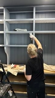

1/5We used VJ sheet on the back wall of the pantry and giprock on the ceiling and remaining walls. Once we had them installed we tape and plastered the giprock and filled the nail and screw holes.
Step 2
2/5Once sanded I colour drenched the room using Dulux Wash and Wear in Press Agent.
Step 3
3/5Derek and I build the pantry shelves and the base box out of plywood, we plan to add drawers as a phase two but the base shelves will work for now.
Step 4
4/5We added timber trim to the face of the shelves to strengthen the shelves and make the look more custom. We also added LED flexible tape lights behind the cornice and trim for ambient lighting.
As the Air fryer and kettle will be in the pantry we added an extractor fan and LED recessed lights
We also found a commercial fridge on market place.
Step 5
5/5The counter top is made out of VJ’s that came out of our original kitchen. Derek planed and cut them down and we sanded and stained them using Feast Watson Liming White stain and Varnish.

Thanks @Dave-1 I can see why you like the shelves, they look good but they're so impractical. At the moment they're just a mess as I can't get to the back of them especially the bottom shelf.
The curve is great, isn't it? I wanted to create a little visual break from the lines of the VJs and shelving so we cut some ply wood to create this shape.
