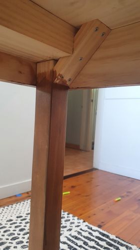

Just wanted to share the dining room table I made from lengths of pine. Quite a bit of time spent sanding this as most of the pine I got wasn't flat. Rounded over the edges with a router. Then gave it a stain and varnish. The hardest thing for me was making it stable. To help with stability I added aprons and some 45degree supports for the legs.

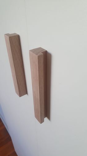

I also made the oak shelves above the windows for the plants. And made new door handles out of oak, using the router to give them a bit of a lip to grab on to.

Added a support piece at each end of the table where I wanted the legs to go.
Got these legs furniture legs but I couldn't work out the bolt on the end. So I took it out and replaced it with a dowel screw. Then just screwed the leg into the table. dowel screws
Added aprons by glueing and nailing them into the support pieces with a nail gun.
Then added a 45 degree support on each leg for further stability - don't judge the underside haha
