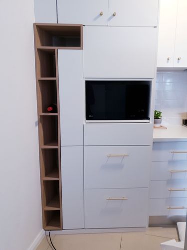

Spent some time this weekend making some built in some custom cabinetry to fit into the awkward space in our kitchen to maximise what used to be the fridge space. First time working with cabinets made for an interesting day.
Very happy with the fit and the warmth the timber brings. *Excuse the missing handles on the other door panels*

That came out fantastic. Who would have thought it was your first time working with cabinetry. You've made use of that awkward space extremely well and I agree that the timber softens the area bringing warmth to it.

I’ve been wanting to do a similar project. Which materials did you use for the cabinetry? I’ve been looking at the Inbuilt Melamine shelving and standard tassie oak.

I used 3 panels of the InBuilt Natural Wood Melamine Colourboard panels at 295x1800mm each and some timber screws suitable for these boards. Handy tip, don't get the shorter screws, I ended up using longer (40mm) ones for better stability.
Hope that helps kick things off and enjoy!
