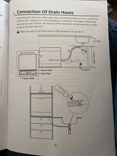

I assumed as much! so sad but i should’ve investigated a little more into it. I read in the manual it says the height must be less than 750mm is that for something different.

So it's saying the max height your hose can rise above the floor (when your machine is on the floor) is 750mm @thisren. That's considerably higher than what I've seen on other models. In your case, the measurement between the floor and the hole in the cabinetry needs to be less than 750mm. What's that distance?
