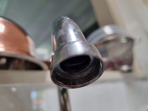

Hi Eric,
I have been trying to find a way to connect the tabletop dishwasher to the tap but was not able to do so.
I got the recommended parts but somehow struggled to find a suitable part to connect from the tap to other adaptors.
Attached is the image of the tap after the aerator is removed and the dishwasher hose. Is there some other part that I would need?
Thank you!
Re: Benchtop DishWasher Tap Connections & Other...
Welcome to the Bunnings Workshop community @skye-t. It's fantastic to have you join us, and many thanks for your question about connecting a dishwasher to a sink tap.
Could you please confirm which of the recommended adaptors in this discussion you have tried? That would provide our members with the required information to proceed further with troubleshooting your issues. By the looks of your threaded tap, a Pope Indoor Tap Adaptor would be a great place to start if you are looking for a quick-connect type fitting. Failing it being able to connect, you could look at a Kinetic Adaptor Aerator Kit.
I look forward to hearing about the options you've already tried and providing different solutions.
