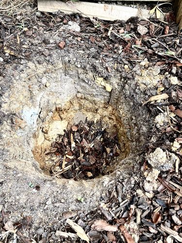

Or drop a leaching tank into the ground. But given the soil profile you can see in this hole below from elsewhere in this garden it’s clay all the way. So I suspect water dispersion from the leaching tank may not be successful. Unless the hole is oversized and filled with gypsum and soil. Is this the best permanent solution?

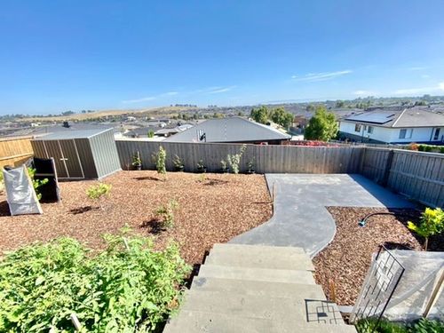

The directions of fall in the backyard are from front to back fence, and from left to right. approx half a meter fall towards the back right corner. There is no easement and the storm drain is located behind that shed, as said earlier.

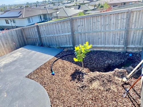

Yes Red, this is why I ran that river away from the fence.
Before this re-routing, the water simply spilled out towards the fence and down the slope for a few months. I tried digging a delta pattern on the reserve side of the fence to disperse the water. Weeds started to grow and I'd basically constructed a creek! Up that creek...

Did you see the 1/2m post hole photo I posted above.
it’s my basic understanding that the clay goes down to the bedrock.

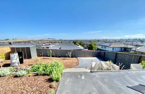

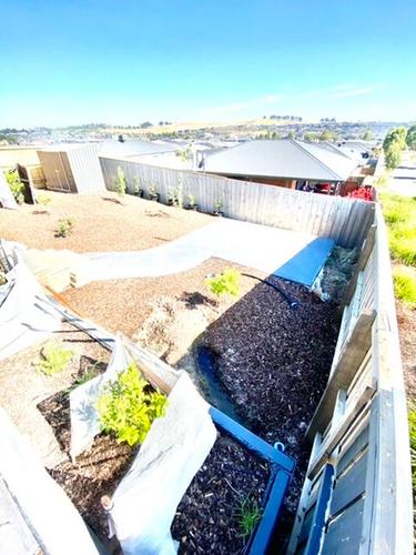

I am updating this situation and post photos of the final solution adopted.

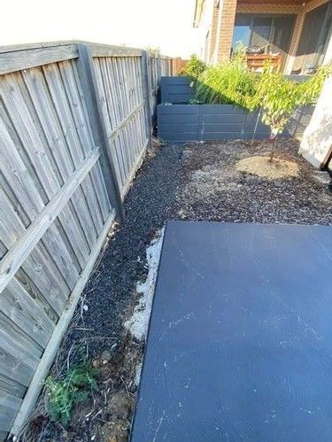

I had a agi drain installed to channel the water down the slope and out under the fence away from the neighbors yard. Water flows into the reserve to the garden there.
The earlier situation where I had dug a channel towards an orange tree located adjacent to the where the peach tree is now killed the orange tree. Basically too much water. And I’d tried to fix that by digging another channel from the orange tree back to the fence. I’d made a River! That again gave too much water to the tree. So I had to get a proper agi drain professionally installed. Removed the dead orange tree and back fill the hole with clay. Then dug a fresh hole adjacent for the peach tree preparing that with layers of gypsum, soil, fertilizer and created a raised plant that you see there now, protected by sugar cane.
Hope someone finds this useful.

This was done over a year ago now and is 100% successful in diverting water safely away.
This problem arises because builders leave agi drains unfinished as they are considered landscaping not part of the build.
Others should be aware if they are using agi drains as part of their house build to plan for safe water diversion as part of their landscaping. And be careful who they choose as landscaper. One guy quoted us $5,000 to fix this, with way over engineering his plan including adding sumps running long piping etc.
