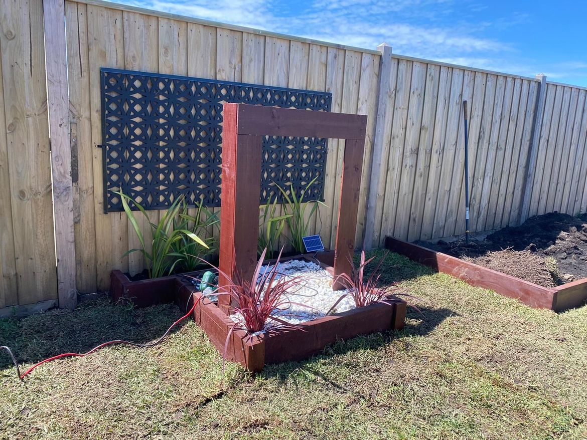

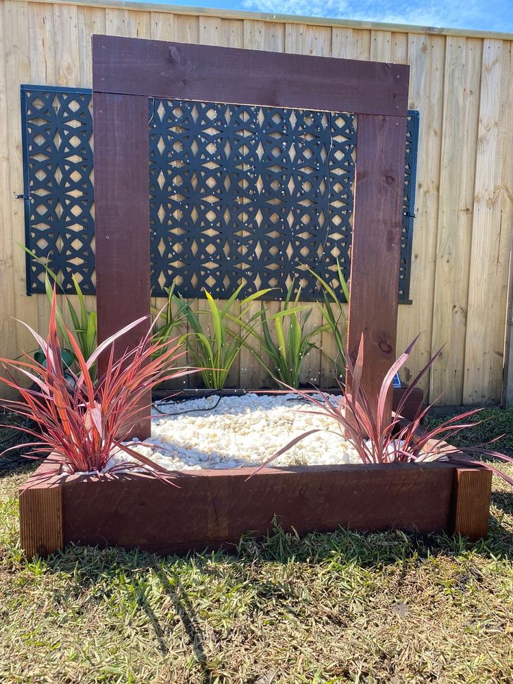

It was not an easy one to accomplish but I was determined to do so.
Steps
- I used ezy 160 liters storage container as the reservoir(https://www.bunnings.com.au/ezy-storage-bunker-heavy-duty-storage-tub-160l_p2583519).
- The pump used (https://www.bunnings.com.au/aquapro-ap750lv-water-feature-pump_p2810056)
- Frame made of treated pine
- Quick set concrete to support the frame.
- used these stakes for additional support (https://www.bunnings.com.au/whites-outdoor-450mm-heavy-duty-steel-corner-stake-sleeper-peg_p1100604)
- used the poly tube (https://www.bunnings.com.au/holman-19mm-x-25m-black-poly-pipe_p3120622) to connect the pump .
- used the drippers for floiw control of the water (https://www.bunnings.com.au/pope-barbed-adjustable-flow-trickler-10-pack_p3120454)
