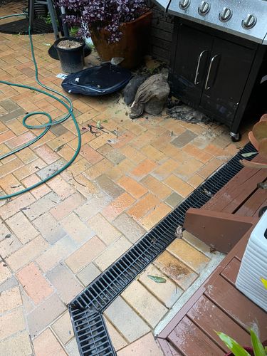

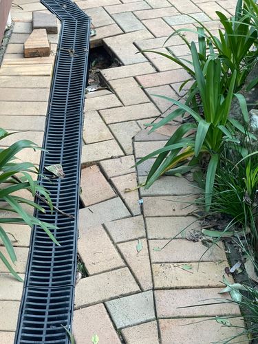

Please advise on best materials to repair sunken paving, due to all the run off water I had drainage installed but further water has affected the leverls
Welcome to the Bunnings Workshop community @brab969. It's wonderful to have you join us, and many thanks for your question about raising sunken paving.

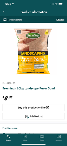

You'll need to remove all the sunken pavers and restore the bedding material. The simplest option might be to add paving sand under the pavers and water it to compact. Add enough sand, so the pavers are slightly proud of the surrounding surface. Once the pavers are re-installed, they'll compact the sand down further and hopefully end up flush with the surrounding pavers.

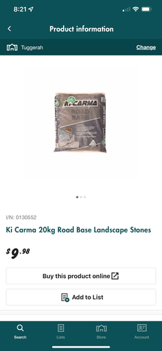

Roadbase to partially fill -compacted

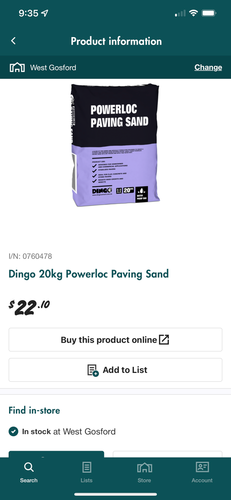

then sealed with powerloc

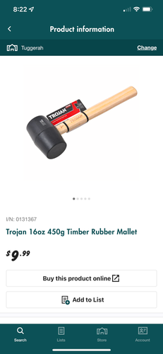

also purchased a rubber mallet which proved invaluable
