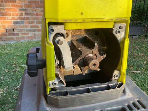

I purchased this Ryobi electric shredder 2nd hand, and it's not working as it should. The model number is RSH2445T. Apparently they are very good shredders, but mine is not cutting right through the material that goes into it.
I'm looking for help on how to proceed with getting it repaired.
A photo of the inside of the shredder is below. The piece of thick aluminium levered up to where the blades spin is the adjustment plate. The plate should be adjusted to just touch the blades, at which point a small amount of aluminium should be shaved off and the shredder should operate beautifully from that point on. The green knob partially shown on the left side of the photo is used to push the adjustment plate in further. Once adjusted, the knob gets locked into place with a locking knob. The issue in this case is that the adjustment plate cannot be pushed any further in, as the knob is at the end of its position. If the adjustment plate was wearing thin, I'd expect it to need replacing, but it's barely been worn down, so I doubt that's the problem. Instead, I'm wondering if something has perhaps broken off the end of the bolt that pushes against the adjustment plate. The end of the bolt has a hole in it with some wire through it, and that looks like it might have been messed with or damaged.
If anyone has a similar shredder, perhaps it could help to look at how the adjustment bolt works, whether there is a part missing, etc. Ultimately, if the bolt was perhaps 10mm longer, I wouldn't have a problem, so there may be other ways to achieve something like that. Thanks in advance for any help!

Hi @Awkwajena,
I hate to say this, but I don't think that end plate will solve the issues with this.
As I'd originally said (somewhere), the wear on that main-shaft (at the front of your picture) is not repairable and the shaft needs to be replaced.
It could be built up with a welder and lathed down to the original diameter, but at the end of the day, there needs to be a  roller or ball bearing race on that end,
not some sort of an end retaining plate, that is why the shaft is worn, having metal rubbing on metal with no bearing, is a very poor way of doing things
with rotating machinery, especially when you add bits of trees and what not taking that shaft off centre as the motor rotates.
Merely putting a new end plate on there will not fix this, this is what my engineering experience tells me.
How far do you want to go with this repair, is the question I ask?

@MikeTNZ I think you're response was meant to be directed to me, rather than @Awkwajena, as it was me that posted the photos.
If you're suggesting there is some play in the main shaft, then I don't think that's the case, and I don't think there's any issue with wear on that part. The end of the shaft is probably supported by hole in the panel (probably not the technically correct name) that I removed in order to access the inside of the machine (not pictured).

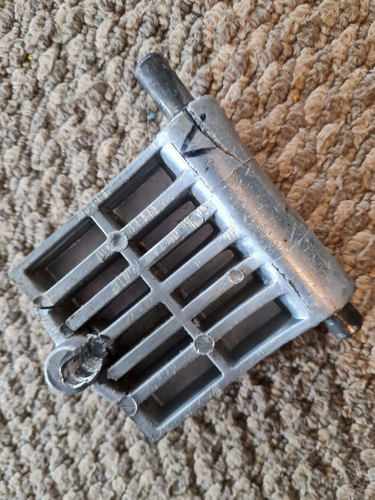

My diagnosis:
I have some more photos of my adjustment plate to share, which may be of use to any others looking at this problem. This model of shredder is designed so that a small adjustment to the adjustment plate will cause the blade to shave a little of the plate (as the plate is softer than the blades) and subsequently provide a very fine tolerance between the blades and plate. I believe the previous owner of my 2nd hand machine over-adjusted the adjustment plate, protruding it too far, and causing the blades to catch on the adjustment plate (rather than shaving a little from the surface). The result of this is that the part of the plate next to its steel shaft split and bent, as well as the part by the protruded bit that sits against the adjustment bolt, and the steel shaft that runs through the plate was bent a little as well.
Due to the bent adjustment plate shaft and damage around the shaft, the protruded part of the plate that sits against the adjustment bolt was no longer aligned correctly, so further use of the machine (and perhaps further poor discipline around adjustment?) caused damage to that part of the plate, eventually causing the adjustment bolt to no longer sit against the protrusion. This caused the adjustment plate to no longer be near enough to the blades to do a clean cut.
I put the adjustment plate in a steel vice to try to straighten the shaft and bend it back into shape, because at this point I don't have much to lose! I think the shaft in the plate did straighten a little, and the cracks may have closed up a little, but overall the plate is now weaker than before and a part near the shaft broke off, as per the first photo.
From here, I suppose it may be possible to custom-3D-print or custom-CNC-mill an adjustment plate, but the cost seems likely to be prohibitive. If I am unable to get a replacement part, then attempting a repair on my damaged plate maybe the easiest option, but there's a risk that if the plate breaks it will jam the steel blades and break them or some other part. Given the lack of support for the machine from Ryobi, maybe that doesn't matter much, as my machine is probably headed for landfill anyway. In the long term if I replace the machine, I'll be looking to see if alternative brands offer better support than 4yrs.
Interestingly, I had a look at some manuals of similar shredders to see what the adjustment plate design looks like. Though I found similar designs, none of them seemed to have the same technique of using a sacrificial adjustment plate that can have the surface shaved off it to give a very close tolerance for cutting. Instead, they prevented the plate from touching the blades, probably ending up with a poorer cut to the material being processed. I wonder if the sacrificial design was too prone to user error for anyone to continue producing it.
