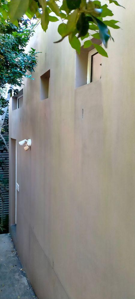

I have also started cleaning the wall of the house as it has mould as well but have found many cracks in the mortar that I had not noticed before. I have the paint to cover the wall when it is all clean but do I need to worry about these minor hairline cracks and what should I do with the larger one's?
Mouldy Wall

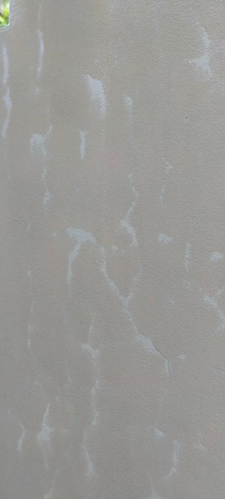

White marks are hairline cracks
Larger Crackes
The wall dried and turned white around cracks
I assume the area around the cracks that dried first indicates high post or lifting around these cracks?
Re: How to remove outdoor wooden steps?
I actually have a worse instance (the render has been cracked and fallen off sections of my retaining wall. Thats going to be a project all by itself!) You cracks are fine but def would hit up the paint people as there may be particular paint to take care of the cracks and also the leeching that is happening. For the larger cracks at the base I really dont know other then removing the cracked pieces and then re rendering the area. I only say that becaus ethere is water at the same level as the cracks. If you arnt worried about that then possibly leave it and keep an eye on it?

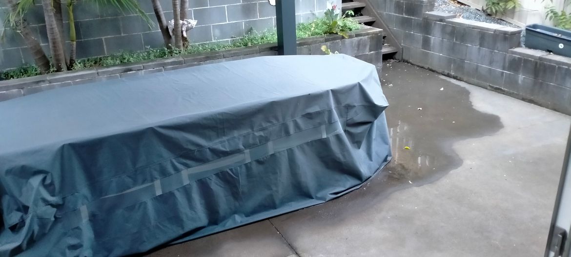

The water problems pointed out at the beginning of this story has improved were I see only limited clear water but before painting I feel I can further improve the water problem by cutting the concrete in front of the bottom step with a catchment and then cutting a drain line away to the stormwater pipe.

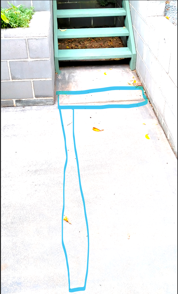

Drainage Design Area
So how can I go about cutting this concrete which is 100mm thick, fit a slim line drain with black cover that sits even with the surface.

Cutting a channel in 100mm thick concrete is likely something best left to the professionals. It would be remiss of me not to let you know that we do hire a Coates Demolition Saw, but I certainly wouldn't advise you to attempt this work yourself unless you have previous experience with such a machine. Not only is it relatively dangerous work, but I can imagine the machine is quite unwieldy.
Once you've had the channels cut for you and the concrete removed, you'll be free to install your slimline drain and connect it to the stormwater line.

I assume that the slimline drain system is higher than 100mm so I would dig out some ground, fill it with a base and concrete and while the concrete is wet push the drain channel into the concrete to level the top of the drain with the concrete area.

The Everhard 1m EasyDRAIN Compact Polymer Grate And Channel is 80mm high, so it will need something to raise its height slightly. I like the idea of embedding it in concrete, as you can then tap it down to be flush with the surrounding surface.

I had a concrete cuter tradie come out and take a look at this job, still waiting on the quote, while he agreed to my drawing above he made an experienced observation that I did see and made an unexperienced decision.
The concrete is sloped to run water to the centre of the entertainment area and running the slimline drain in a different direction to gravity I would end up with a drain that would be lower than the concrete surface at one end or a drain that was level with the surface but the water would sit in the drain.

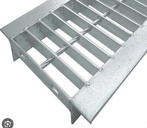

The solution seems to be placing a grate on top of the concrete and cement the channel back in with a slant to runoff the water to the storm water drain that is shown on the house plans.
I want the drain to be as flush as I can get it for safety but I should consider a grate that sits on the concrete with shoulders that sit inside the channel to hold it in place which would also hide the cut surface and be a few mm higher than the surface.
