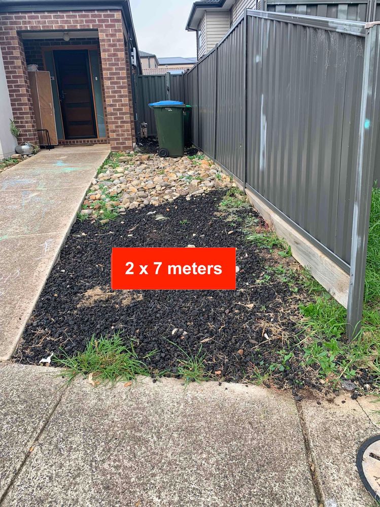

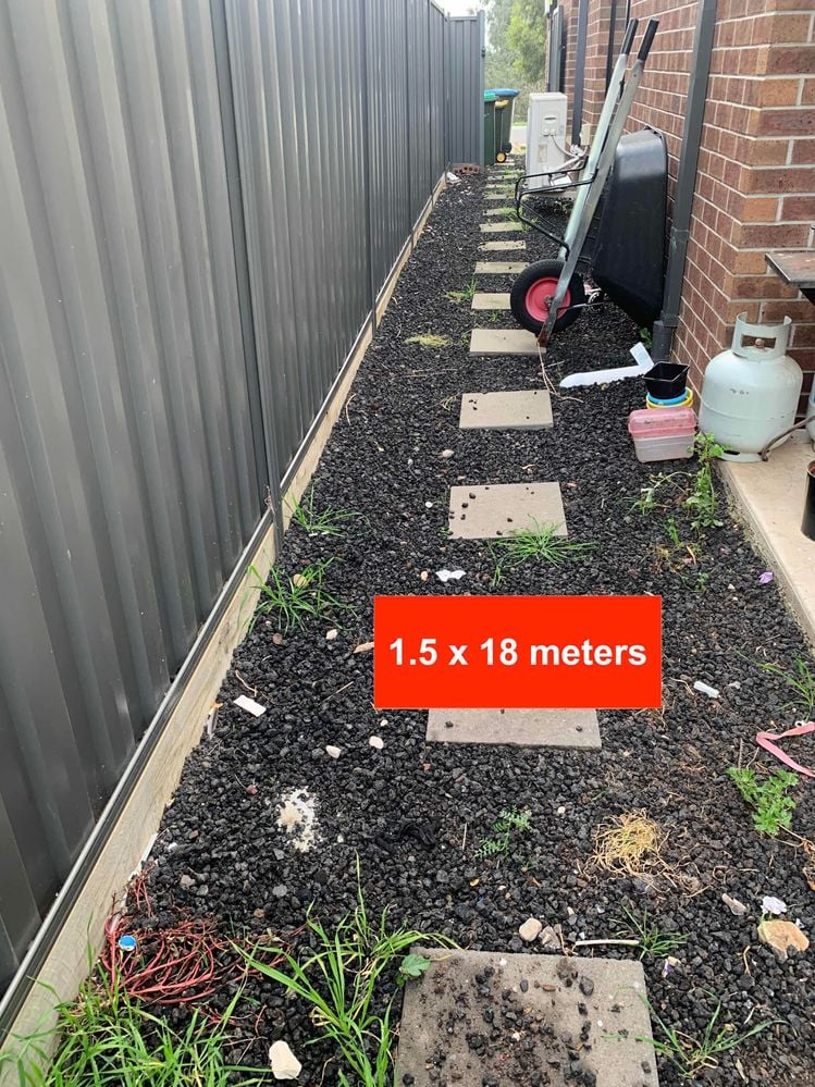

Hi guys,
Need some advice, I'm thinking to put a synthetic grass on side way and front yard. There are mostly lava rocks there. Do I have to remove those before or should I mix it up with something as underlay for the grass? which material would be best in that case? There's 10mm depth.
Thanks,
Hasan

The lava rocks would be unsuitable as a base as the surface will be uneven and they are extremely hard. It's important that the ground is smooth and flat and I'd advise you to level the area and remove some of the lava rock to increase the depth you have to work with. It's advised to spread 60-70mm of roadbase across the area and level it before compacting. You'll then apply a 20mm covering of sand, level it and compact that as well.
This will give you the best sub-base to work with and ensure the correct installation of the product.
