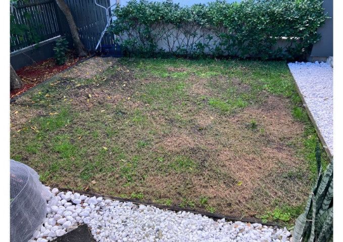

Hello,
I am getting quotes to install Artificial Grass that is Pet friendly and found https://k9grass.com.au/, they said it will be a minimum of 5K 3.5x3.5 m and I am thinking of doing it my self as per - https://www.bunnings.com.au/diy-advice/garden/lawn/how-to-lay-synthetic-turf
I want to put high quality turf my self and have some questions;
1. What is the best Turf for Pet? (Non-toxic, Headblock resistant, pet-safe, Urethane Backing, Polyethylene)
2. Can I purchase ZeroFill from Bunnings - https://k9grass.com.au/oc-zeofill/
3. What is a good weed mat.
4. I was going to use Roadbase to compact and create a solid base as I want to exercise on top of it in the future. What product should I use for sand or roadbase.
5. What is the best way to kill the weeds and remove the grass.
