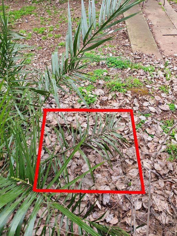

Don't shoot the messenger, but below is a photo of a storm drain, well, sorta. It belongs to an 80 year old lady whose property adjoins my backyard.
Council went through our properties with a similar drainage network as described above which wormed its way though backyards. She told me one day she didn't like it so she placed shopping bags (when they were plastic) over the 'vents' and shoveled dirt on top. I lent over the fence for this shot just now and noticed a fern successfully growing. 😁
She was so proud at the time, I just didn't have the heart to explain.
Now all this happened 20 years ago.

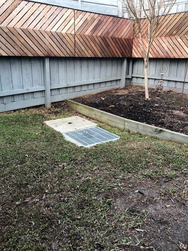

They certainly weren't installed by the owners. In fact council intended to put one in my backyard but I had a small shed not indicated on their plans. But they left the grill. Dunno why.

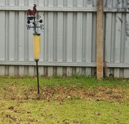

Northern neighbour has grass growing over his next to a weather vane. Maybe I should stop typing and start building an Ark?

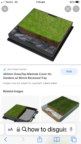

Now that looks clever. Is this meant to take the place of the galvanised grill seen in your photo?

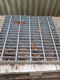

Can you lift your grill?
Is there a concrete lip to support this British idea?

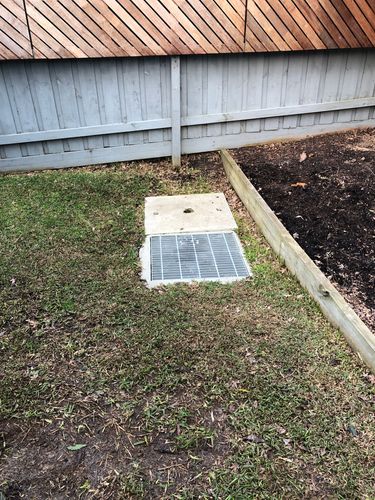

And forgive me - one more question. What is that small concrete slab next to your grill?
I guess I'm thinking if there's nothing in Australia, we can steal the Brits idea - and make one. Do you weld? 😁
Re: How to hide a stormwater drain?
Or...

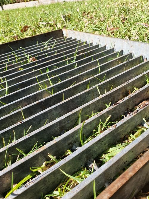

Can we flip it over? On the one that was left with me the grills are now lower than the top edge. Would this now be the best spot to lay our fake grass - which would now be level with your lawn?

Hi @SueGillian,
I haven't come across that type of product before. My only concern with placing something like that over the grate is if the pit also serves as a surface water collection device. You would basically block all water from draining into the pit. This likely wouldn't be an issue most of the time, but in a torrential downpour, you would probably end up with a new pond feature in your backyard.
The pit has been installed sunken quite deep into the ground, and this alludes to the fact that it could be placed there not only as an access point but also to collect the runoff from the surrounding area. What's on the other side of the fence? If it were an apartment block, this grate would no doubt be placed like that to capture water running under the fence.

You don't think fake grass would be porous enough? Using reverse Google image - I found Sue's British site...
https://geotextilemembranes.co.uk/450-x-450-x-100mm-ecogrid-grasstop-recessed-manhole-cover.html
And from it...
"GrassTop Manhole Covers are a unique product offered only by Recessed Manhole Covers. These were developed specifically for gardens and lawned areas so that unsightly manhole covers no longer ruin the surroundings. With pre-drilled drainage holes and a double layer of factory fitted specialist membranes, grass can grow in the recessed tray while the water is gradually filtered through."
