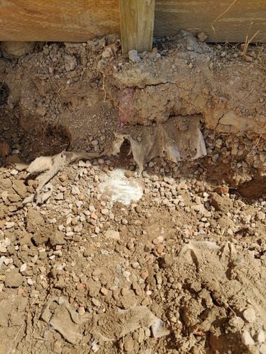

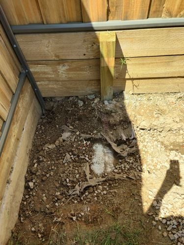

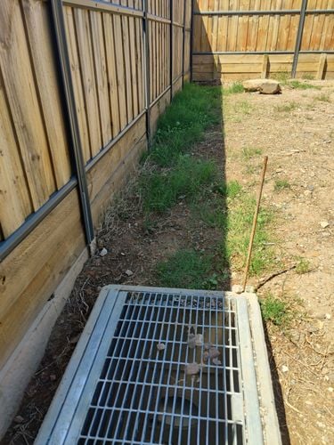

I've got a stormwater pipe going perpendicular to my land at the end of the block and connecting to stormwater drain in the left corner of the land.
I was digging to put in an ag pipe and after digging a bare 10cm I hit this giant pipe on the right side of block.
On the right side pipe is burried only 10cm deep while on the left side where it connects to the drain it's over a metre deep.
I don't understand what these geniuses were thinking putting in the pipe so close the surface.
I'm gonna plant privacy plants at the back fence (most likely golden palm tree) and now I'm worried if the roots would be an issue for this pipe ๐Ÿ˜ž

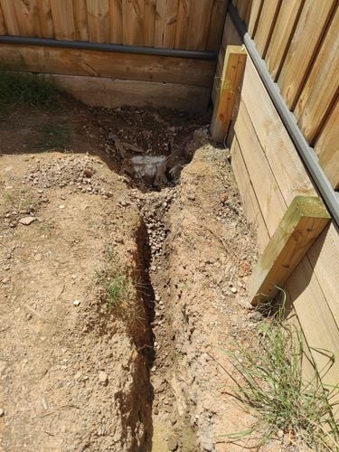

Just some additional info, the pipe seems to be wrapped with fabric and gravel (see photo below) which i am now ripping apart as I need to dig the clay soil out and replace with top soil. I also need ti dig under the pipe so I can pass my ag pipe next to the end retaining wall. Although I suspect there's an ag pipe already running along this pipe to the stormwater drain since I can see the exit to the drain.

It's certainly not an ideal location for the pipe, but I believe 100mm to the top of the stormwater pipe is in line with the Australian and New Zealand Standards. It might be worth contacting your local council's water authority to ask some question as rules may be different in your area. It is certainly possible to bury them deeper, but it looks like it is up to code. These types of stormwater pits are also often council assets, so any modifications would likely need to go through them anyway.
Roots can certainly cause problems with pipes, so planting privacy plants directly over them is not ideal. As their roots will seek out water, they can potentially find their way into the pipe causing blockages and damage to the pipe.
You could install a root barrier such as this Jack 600mm x 5m Garden Root Barrier around the pipe as an extra layer of protection, but you might still have trouble in the future.
Unfortunately, I think the best solution is to avoid planting in this area.
You could install some fence extensions to add privacy on that side of the property. A physical structure like a pergola or shade sail could also be a good option.
Allow me to tag @Nailbag, @prettyliving and @michael1972 to see if they have any ideas.

Looking at your fence line, it sits upon a retaining wall. This means that in some earlier stage that pipe was further under the original ground prior to your land being excavated. Though not a satisfactory answer to help your situation it would explain the shallow depth.
As the length of the fence line appears to be an easement, I would have to agree with @JacobZ in avoiding planting in this area as it would contravene local guidelines. Any issue arising from the tree roots would be at your cost.
But you could still plant further in front clearing the easement and utilising the root barrier Jason suggested.
