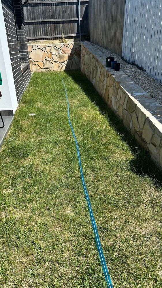

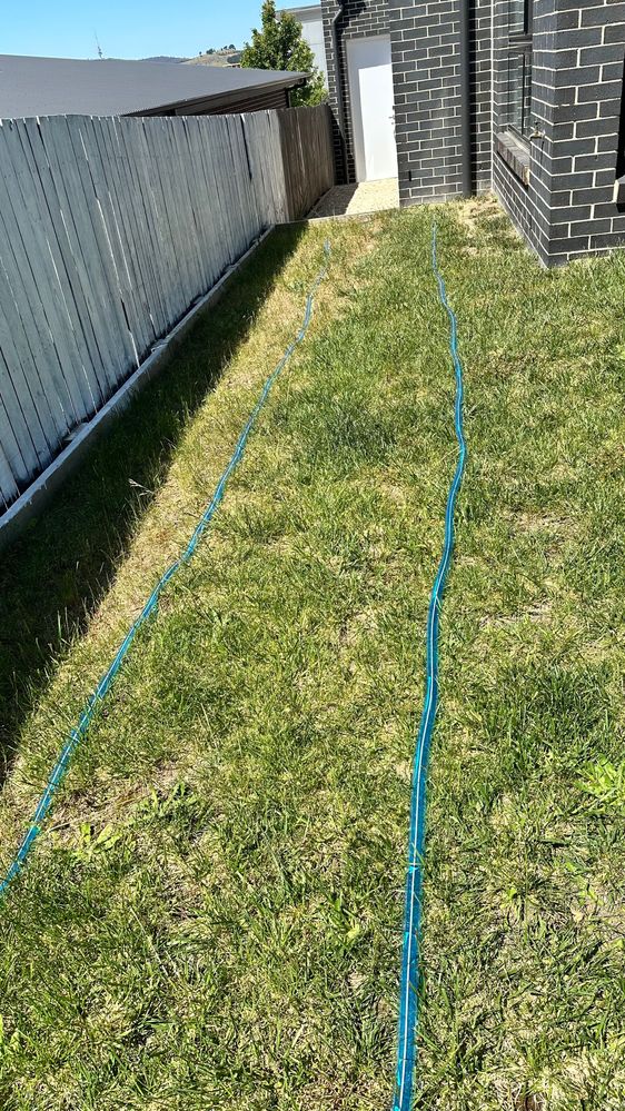

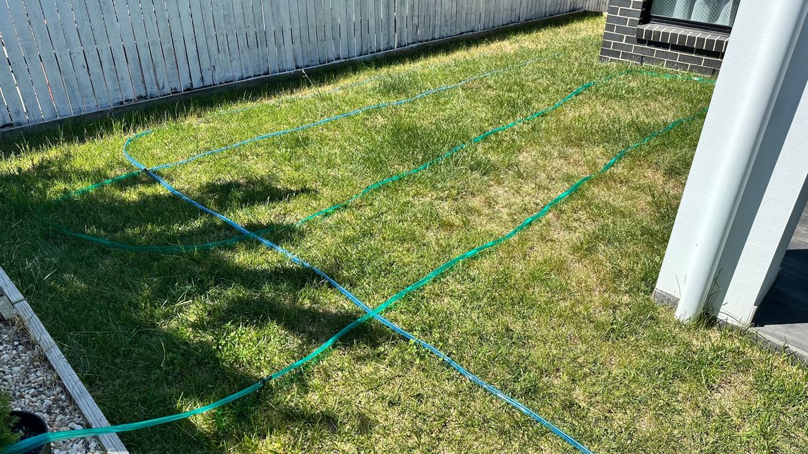

Re: How to fix flat soaker hose leakage?
Hi @pc007,
Do you have a photo of the path you can share? Are there garden beds? Is the path concreted or is there dirt that you could dig into?

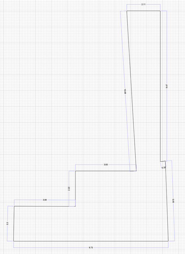

Thank you JacobZ.
Attached the grass area plan with dimensions.
Hope it helps. All dimensions are in metres.
Hi @pc007,
You've got quite a complex area to cover there with pop-up sprinklers. I'd recommend you spend some time using the myGarden planner which will show you where the pop-up placement needs to go. Given the complexity, the number of popups required to cover the area entirely and the amount of pipework that needs to be installed, I'd recommend a professional installation.
I've had a go at putting a plan together, which I'll attach below.
